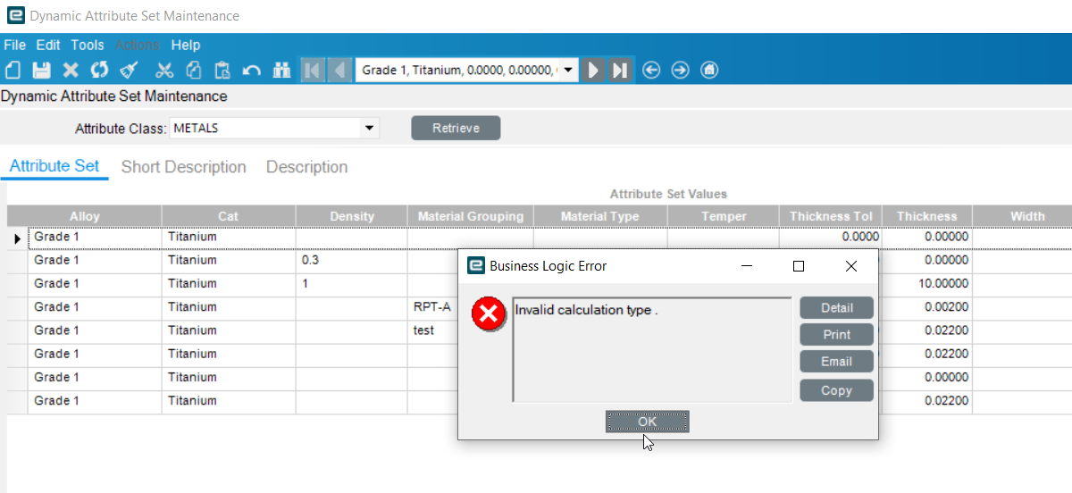

Below is the DMT template i’m using. But I’m getting an error for every row that says:
Invalid calculation type .
That space after “calculation type” makes me think I left calculation type blank, but I don’t see a DMT field for specifying calculation type, so I’m not sure what it means.

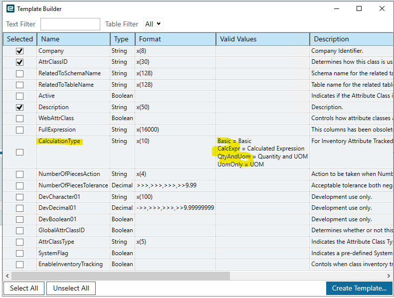

Calculation Type is in the DynAttrClass DMT template.
Perhaps check that the Class you’re providing AttrClassID is valid.
DynAttrClass, Details and Values must be loaded before Attribute Sets. The former 3 can be loaded in one DMT using the DynAttribute Combined template.

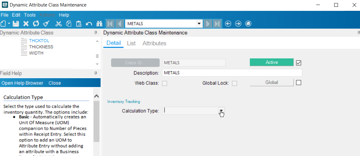

Well, that field is blank for my attribute class. I’m guessing that field is part of Advanced UoM because its disabled, as is the Track Inventory Attributes checkbox in Part Maintenance. I just want to use Dynamic Attributes without AUOM. I’m able to create attribute classes, assign them to parts, and assign attribute values via Part Maintenance one-by-one, but hitting this roadblock with the DMT. Is there something I’m missing?

When you create the attribute class, you are unable to select the Calculation Type? Also, what are your options in the Related To field?

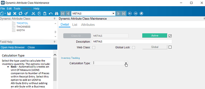

When I select the dropdown, its blank.
And I don’t see a Related To field, except in the DMT template builder.
I seem to recall CalcType is disabled before we licensed AUOM. To use AttrSets on parts you can do that on Part DMT, like so:

Had to add the menu. Tried copy/pasting. At least the “error” is consistent!
Bummer. I’d call it a bug, but support would say it’s by design cuz you don’t have AUOM.
Could try setting Calculation Type to ‘Basic’ on Class via API. (?)
