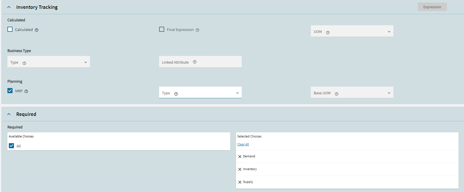

here is my setup:
dynamic class
attribute type basic
4 combo box attributes
all attributes MRP planning
havent used type: theorical, actual, both
required: everywhere
the 4 attributes are standards linked to the part (ams,asme, astm,…)
each of thoses attributes have a drop down list of about 5-10. I want thoses attributes to be managed by mrp so i can have manufacturing and purchasing suggestions with a specific attributes combination. ideally i would be able to use a specific plannings sets per parts.

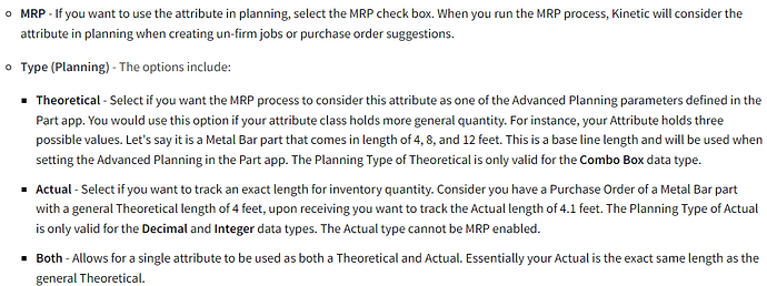

I would look in the Help for more information. But in order to be able to use the attribute as a Planning attribute, you need to select a Planning Type.
Let’s say you use a lot of pipe. If you have a method that requires 2 feet of pipe, you can set up a Planning Set that says you want to purchase 4 feet when there is demand. The Actual length is the 2 feet and the 4 feet is Theoretical and is what triggers a PO Suggestion.

If the mrp is unchecked, PO and manufacturing suggestions dont included the attribute set. The only way i have made it work it by creating planning sets. I might be in the wrong. Also seems like the only way to create planning set is by choosing demand in available and the checking the mrp checkbox. It then crates all the possible combination and all thoses planning sets are activated on all parts having that class.

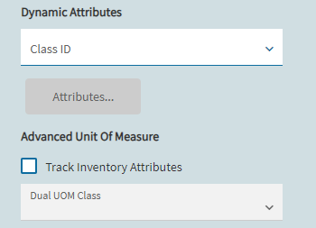

Do you have Track Inventory Attributes checked off on the Attribute tab in Part Entry?
it is checked

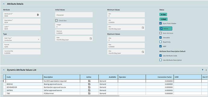

You created a list of values for each combo box? Post a screenshot of one of them please.
You need to fill out those fields; Operator, Conversion Factor, and UOM. They don’t do anything in your instance, so I would just put the operator as *, conversion factor as 1, and UOM as EA.

That is correct. Once you use a Dynamic Attribute Class, you can’t change those fields, forgot about that. Create a brand new class and set those fields. It should work then.
Locked even in a new class. Sorry .

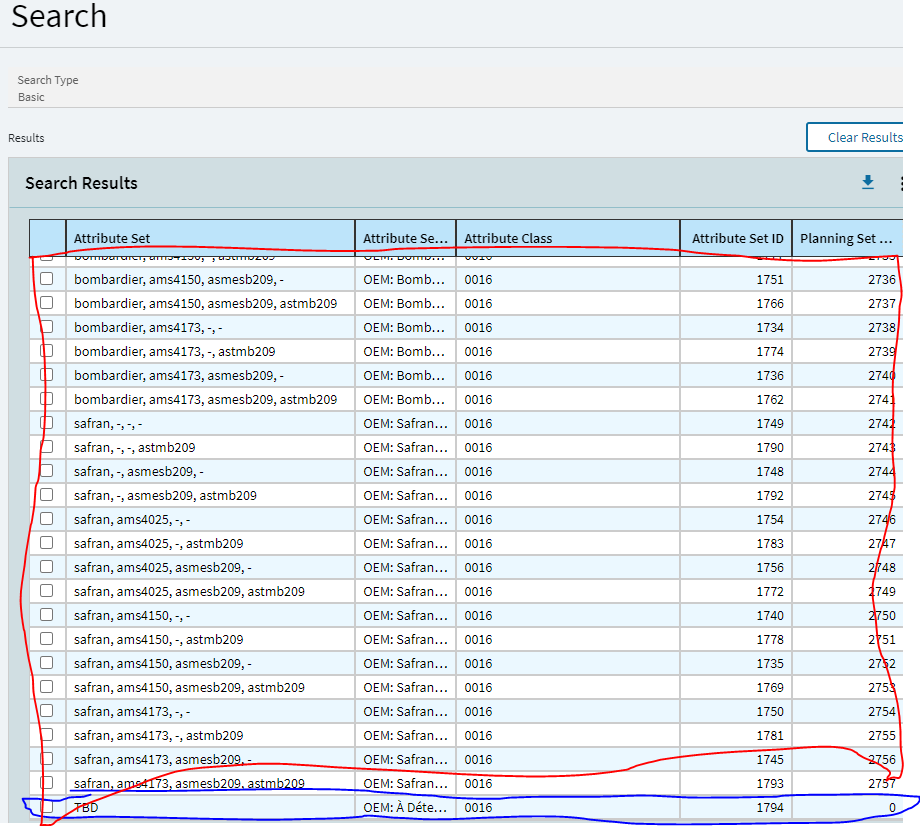

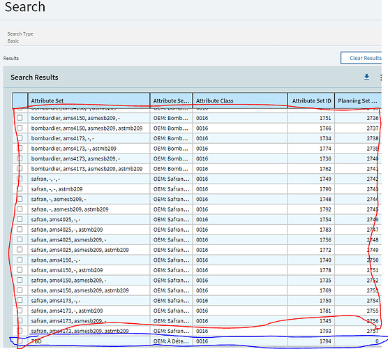

Creating dynamic attributes sets does not mean it is a planning set . Here is an example . in red is a plannings set automatically created, in blue the manualy created dynamic set. You can see no planning set number is related to the dynamic set .
the mrp does purchasing and manufacturing suggestions on the planning sets but dont do anything if i select the dyynamic set .
Planning type does nothing for me since the attributtes have nothing to do with the qty. I cannot use any of them. They dont work.
theorical = needs to be a qty and combo box
actual=integer or decimal , have to be use with theorical
both =needs to be a qty and combo box
