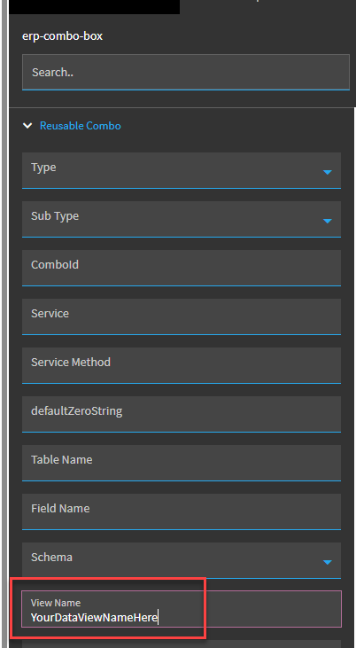

Yes, and then reference the each here:

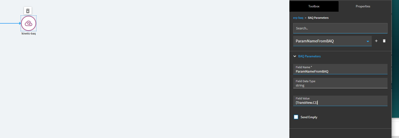

As of 2025.1, the only way you can specify parameters to send to a BAQ is with the ```kinetic-baq`` event widget (or whatever the name du jour is).
Presumably, you set your epBinding on ComboBox1 (let’s call it TransView.C1).
You would have a ColumnChanged event on TransView.C1.

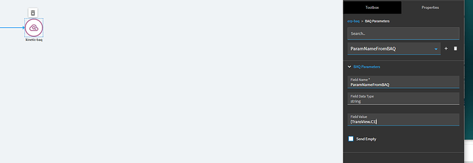

Within that event, you can call your BAQ with the kinetic-baq widget and specify the value for the parameter here:
Following that, rinse and repeat: create a new ColumnChanged event for your second combo bound to TransView.C2 (or whatever) and repeat the steps.
The epBinding holds the selected value.
The dataview holds the data available to show in the dropdown.
