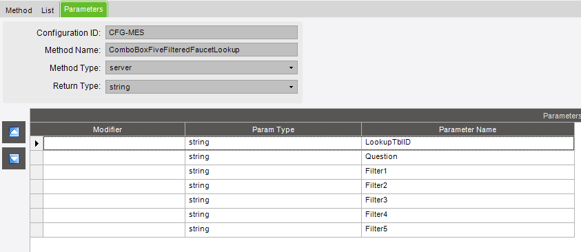

I am passing the following parameters to the UDMethod, Once I got the error I also sent all the inputs so that I could pass out the values that the UDMethods was using into a new variable and see where the error is happening (See the Inputs.ErrorMsg_chr.Value line of code).
As you can see from the image below I am setting the dynamic list information with the UDMethod as well as the filters.
