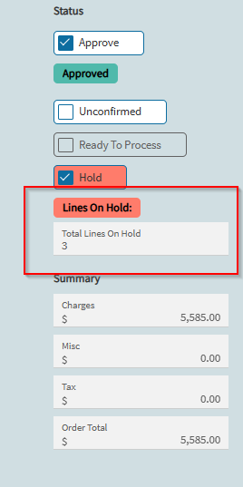

I’m converting a customization that displays the number of lines held on a purchase order.

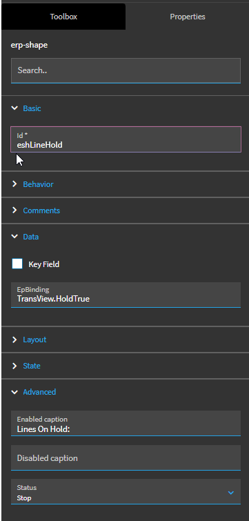

In classic, we use an Epi Shape to display lines held + number of lines. I thought this would be easily repeatable within App studio using erp-shape component in 2024.1.
Has anyone found a way to dynamically set an erp-shape value along with concatenated text? Or with just a dynamic value for that matter.
Setting the binding to TransView.Value doesn’t pass the current row value to the shape, in example like the erp-label does. I also tried setting the caption for the component with different syntax to test but no success. ex.(%TransView.Value%; {TransView.Value}
I’ve settled with a text box below the shape holding the value as pictured below, but hopefully will find a solution to condense into one component!

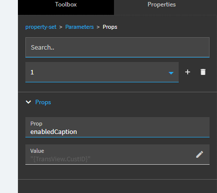

Component Setup:

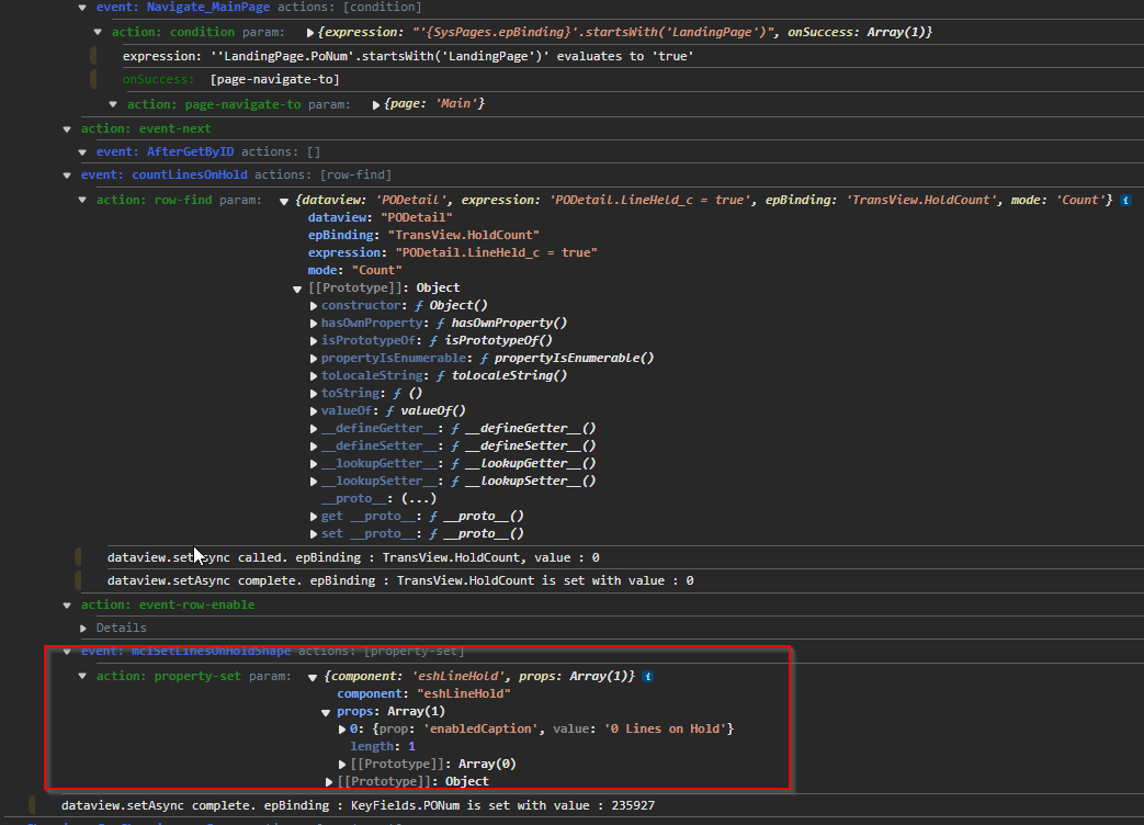

Create an event and use the property-set widget.

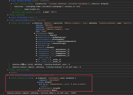

I’ve hooked the property set event into the after get by ID, along with my even that counts the lines held and binds the value to the TransView field.
Although, the value is being passed the shaped doesnt display it. It does display after searching through a few new PO’s. Basically, the value that is stored in TransView is always updated, but the value that is displayed in the shape is from a previous PO. Any quick thoughts?
Now, I change to PO with 3 lines held, but the display is the previous record of 0 rows held.

Solution I ended up finding was to use the OnCreate event to get the initial values from the count as you suggested.
I then added an event-next to my CountHeldLines Event. I then call the property-set through the widget. That ended up being the trigger to find consistency in transferring values.
