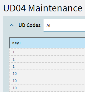

UD table contains a range of lists where Key1 = list type and Key2 is List Item ID. Other fields in that UD record contain relevant data for the purpose of that list/list item. There is a lot more than only code + description.
There is a substantial amount of list types. New types are added on a regular basis.
I am looking for a way to dynamically generate View Options for the landing page without the need to enter them manually one by one. Purpose is to see the content of 1 particular list (select UD04.Key1 = x).
It is an option to define list types in User Codes with code + name, but so far found no way to dynamically generate View Options from this (or anything else).
Second issue is an alphabetically sorted list of View Options, even when new options are manually added at a later moment.
