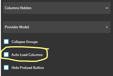

Since you have a BAQ set up to play with… I’m wondering if you would need to combine this setting:
Grid Model (at the bottom):
This autoloads the columns from the DataView.
And then you would need to add a dataview-clear action into your event when your BAQ fires.
What I’m not sure of is whether that action simply clears the VALUES out of the target dataview, or if it wipes it clean and when your BAQ runs it may repopulate the dataview with a new column set as well??

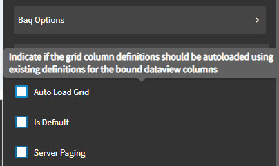

There’s also this one on Grid Model > Provider Model
But, I can’t really get a good grasp based on the hover-text.

I have done the first portion, you can have it self set up.
Can’t remember if I had to check Auto Load Columns.
However, I did not go any further, refreshes would not reset the grid.
