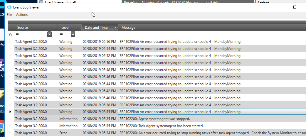

Well I did find this that start happening when e-mails stopped working. So I think it might have something to do with it. Let’s see if I can kill Pilot and get prod running correctly.
We restarted the server, and it’s working again.
I think it’s related to a bad DMT version. When I tried to use the latest, things got hung up and derped up everything. That was last Friday. Now that we have reverted to an older version, and restarted, things seems to be working fine.
