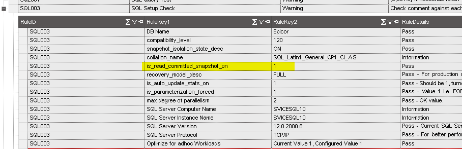

Are you getting a lot of those deadlock errors? We had that problem when we first went live on E10 - it was miserable slow and crashed a lot and errors all over the place - and then happened to realized that I had changed a setting on the database that needed to be reset - and that Epicor by default when creating a database does it this way. It was the read/write isolation level setting on the database that we needed to change to the Epicor recommended - as you can see in the Epicor PDT config check:
If interested, some further reading:
Hi Adam
Unfortunately it’s set to 1 as above.
Thanks for the suggestion.
