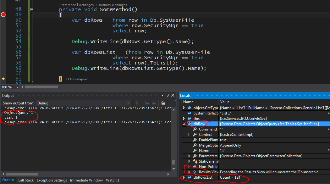

I always start with this example when teaching our devs.
Note the same query done two ways. The first is ‘vanilla’ and the second wrapped with a ‘ToList()’.
The first has an advantage in that it only loads up into memory the list as needed. It’s Enumerable.
The second changes the type to a List by spinning up a new object and materializing all the data from the db query into a concrete List. Great for perf but if a million records are in the query, you just took out all available ram on your app server.
One other issue is that that List object is bouncing around in memory until the dotNet garbage collector comes along and cleans it up. If you have a ton of objects laying around then your server spends all day collecting memory instead of serving up data to the clients.
*Anecdote - We messed this up in the first internal Proof Of Concept in ICE3 years ago at MS. We spent over 30% of the app server garbage collecting. Three line fix, scale and perf skyrocketed. I love simple oops. :slight_smile:
So make your usage of collections an intentional choice and balance the trade off between memory usage and perf and increasing objects in memory.
