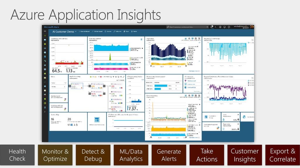

Where Does The Data Go?
Epicor uses Azure Application Insights. System Admins you might notice frequent pings to dc.services.visualstudio.com or dc.applicationinsights.microsoft.com

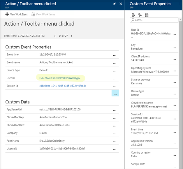

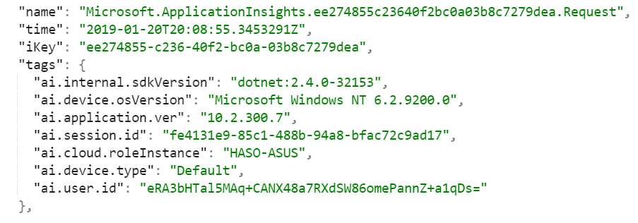

What Data is Collected?
For each telemetry event Epicor collects Event Time, Event Name, Device Type, Company ID, User ID (Hashed non-identifiable), Session ID, License, Client IP Address, City, State, Country, Operating System, Computer Name (Cloud Instance) and Epicor Version .
NOTE: The IP Address may no longer be included, there are posts about Azure stripping the IP Address in order to comply with GDPR. I assume the GeoLocation Data such as City, County came from the IP Address - Epicor is not transmitting it

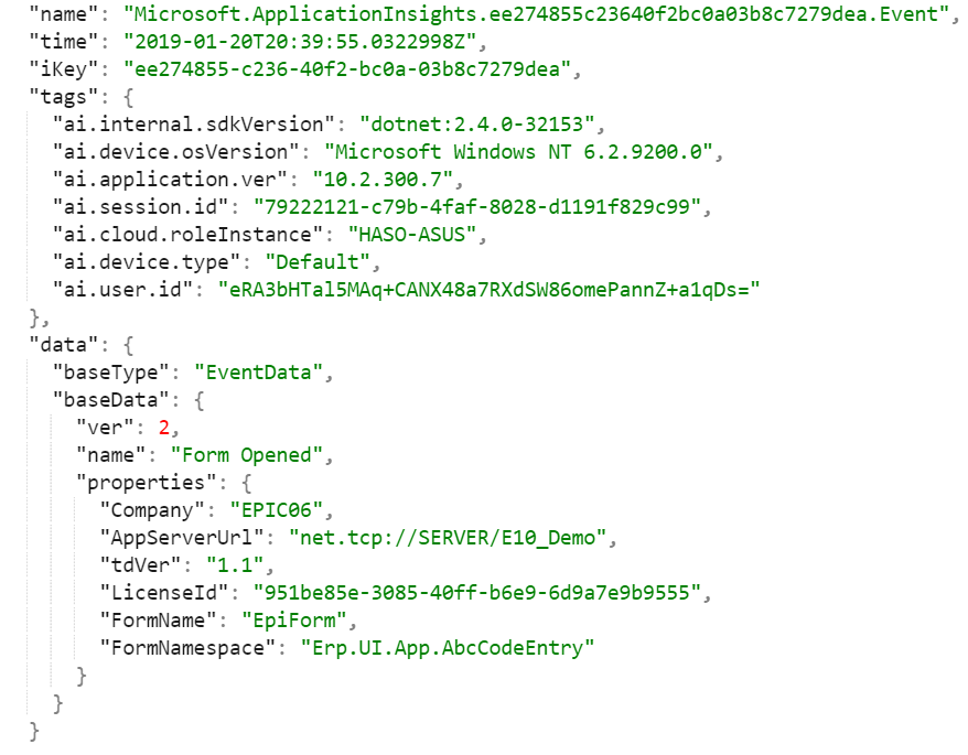

Complete JSON REST Call may look like this

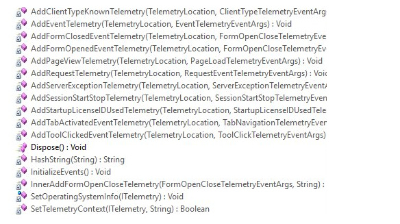

Company, License ID and Enabled Modules
Collects the data about companies, purchased licenses and modules.

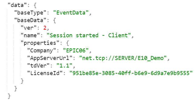

Started Client Session
Collects the data about started session.
5
Server Exceptions
Collects the data about errors on the server side. This includes Failed Methods and Stack Traces.

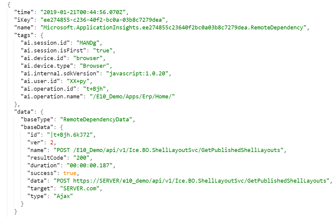

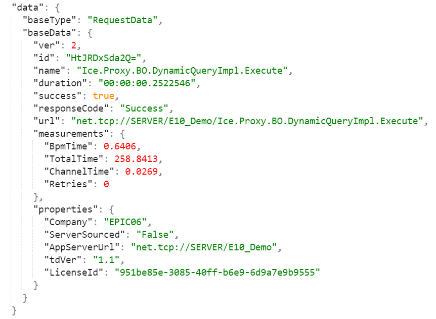

Server Requests
Collects the data for any server request sent from client and server.

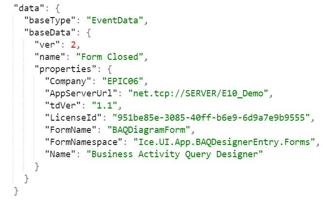

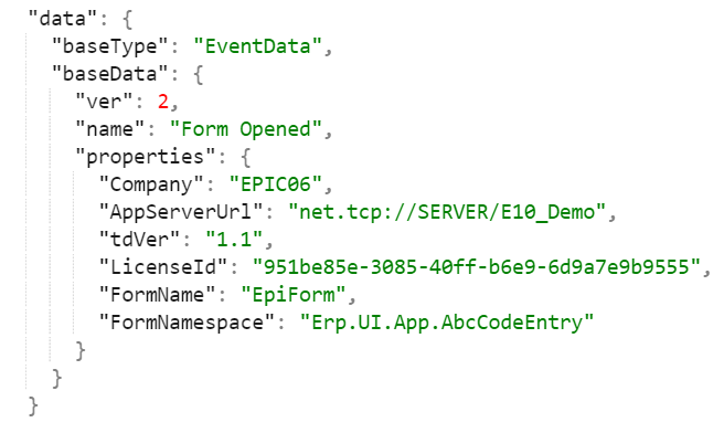

Forms
Collects the data about recently opened and closed programs.

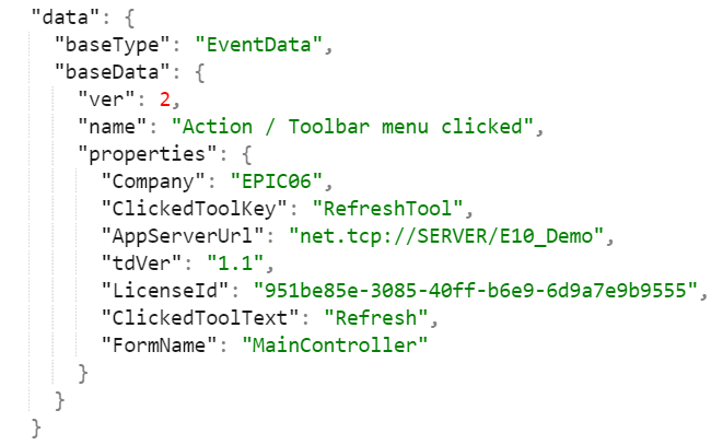

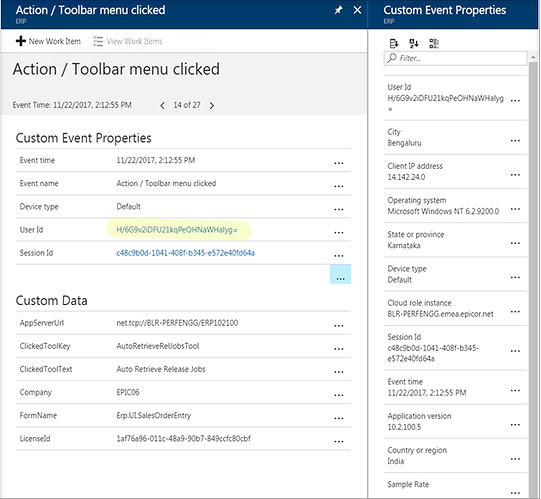

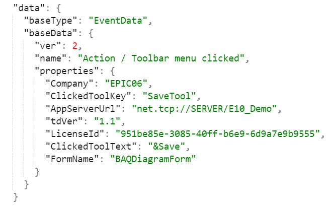

Clicked Action Menu or Toolbar Item
Collects the data for Action Menu or Toolbar Item.

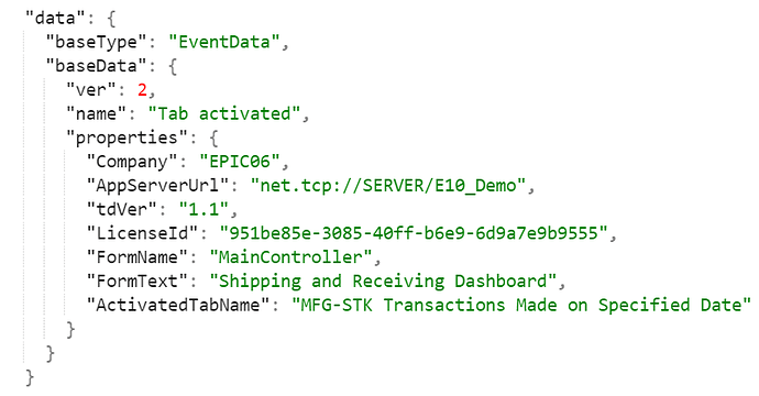

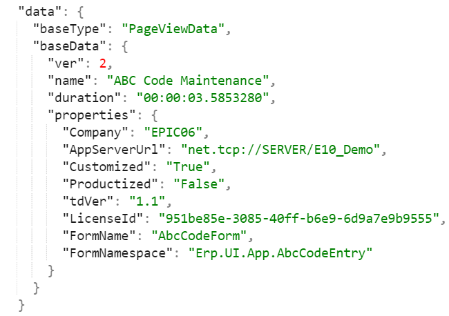

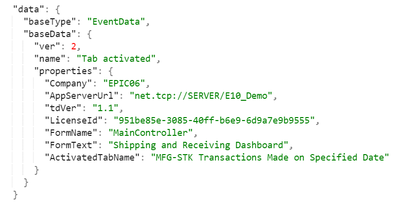

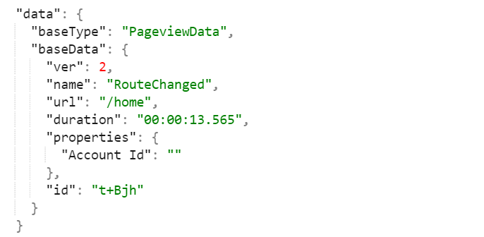

Activated Tabs or Sheets (Pages)
Collects the data about recently opened tabs and page views.

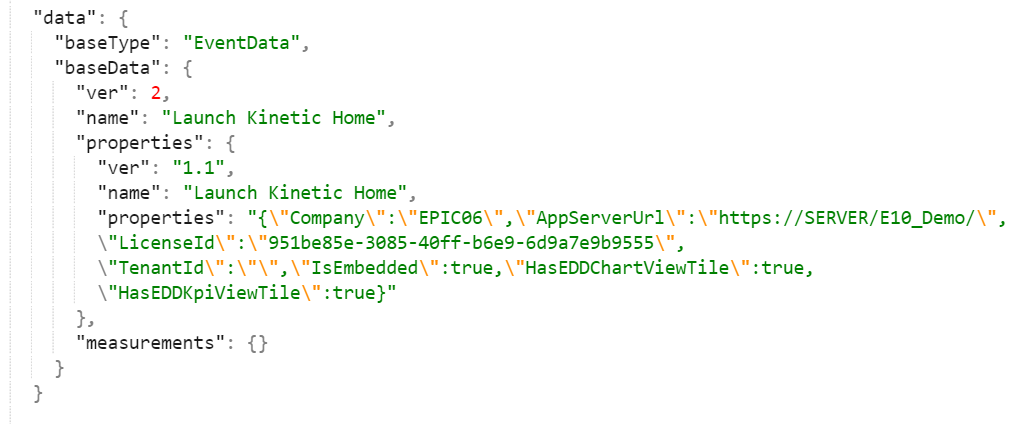

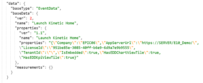

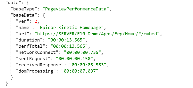

Active Home Page Usage
Collects data about Active Home Page usage.

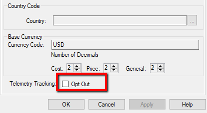

If you or your company still feel uncomfortable sending telemetry data, here is how you opt-out:
You can opt-out by using the Admin Console and navigating to the Application Instance’s Companies Section. Epicor will continue to send telemetry for each client that has an active session, once you restart for example your Epicor Client, the Client will no longer send telemetry data. There is no IIS Restart required.

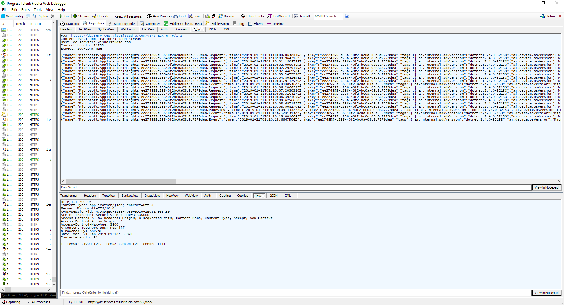

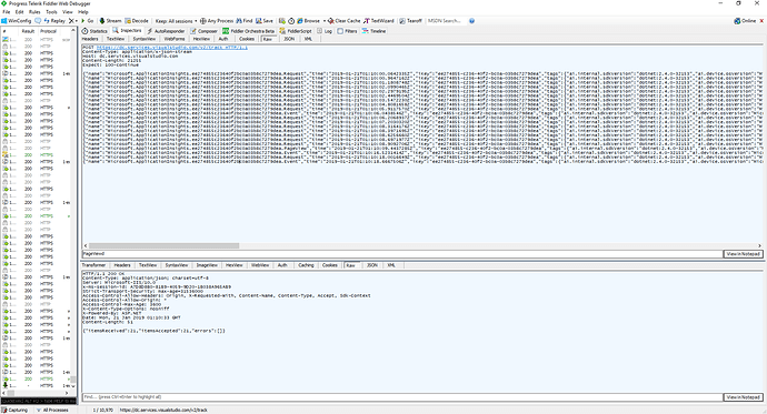

Your Own Research?
If you would like to do your own research, you can download Fiddler and monitor your HTTPS traffic.
