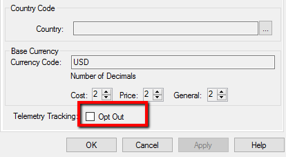

The checkbox is located in the Companies Properties

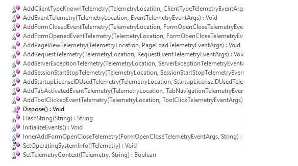

Does anyone know how much Data Epicor Collects int more detail? Upon further Inspection the Telemetry DLL exists also on the Client side as well (not just Server). Does it send each time you click a ToolClick or Open/Close any form?

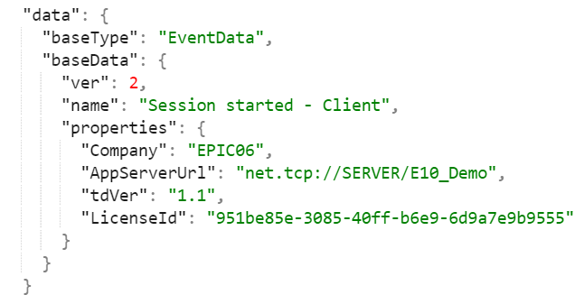

Started Client Session
Collects the data about started session.

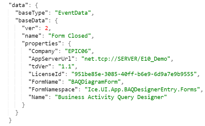

Forms
Collects the data about recently opened and closed programs.

If you or your company still feel uncomfortable sending telemetry data, here is how you opt-out:
You can opt-out by using the Admin Console and navigating to the Application Instance’s Companies Section. Epicor will continue to send telemetry for each client that has an active session, once you restart for example your Epicor Client, the Client will no longer send telemetry data. There is no IIS Restart required.
