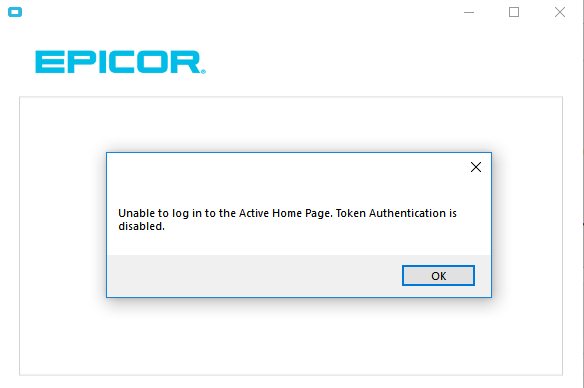

The Active Home Page has been working great. I started a “mock go live” upgrade today and reset the database on the new servers. I have processed the upgrade and initial login for conversions. I have rebooted the application server. I have also redeployed the app server to ensure the cert is loaded into the database and token service is properly configured. However, I am still getting this error when I try to login. Can anyone assist?

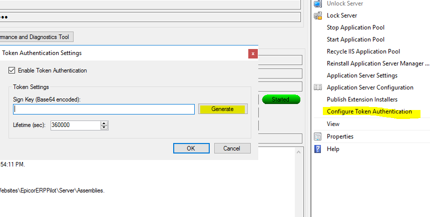

In Epicor Admin Console, have you configured token authentication for the server you are testing?
Thanks Adam! This is exactly what I needed. Appreciate it!
