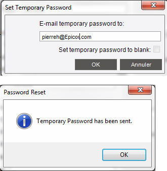

That’s new! So if you don’t have the e-mail set up from epicor (or you broke it on purpose in test) that means you can’t get a new password?
I think you can still clear the password in the administration console…
Selecting to reset ask for the user email … shows the actual email if present… Pressing Ok sends it.
Here is the email received:
The temporary password below can be used to login to Epicor.
Rwo/tWl;uU
If you are still experiencing problems logging into the Epicor application, please contact your System Administrator.

If you’re in testing mode, you can still blank out the password. As SaaS users, that’s just not cool though. Security through obscurity isn’t really security.
You CAN override the email though. So when I set up a user/password for Epicor support (because SaaS users don’t have to “send us a copy of the the database”), I change it to my email, then I login with the temp password sent to my email account then change it and send that password to the Epicor Support person.
