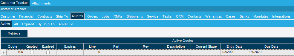

Hi Pedro,
The Customer Tracker has all that - It has tabs for quotes, orders, invoices, shipments… And if you want to see attachments, right-click open-with on the quote or order… You do need to click on the Retrieve button to bring it in (maybe automate that if you don’t have massive lists).
Or create a dashboard / Active Homepage view to show everything…
