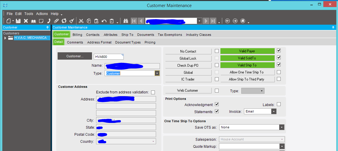

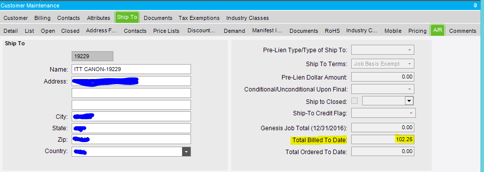

The end goal, to my knowledge, is to get the current amount that needs to be billed to the customer per shipto. When going into a customer as seen below, depending on the amount of shiptos it can take as quick as 2 seconds for new customers with little to no information but in the case of customers that we do many jobs for it can take up to a few minutes at times.
Once the customer is pulled up you can see their total bill to date. This code is supposed to grab that information and display it here. It is mainly used by our credit department to be able to have easy access to this information when looking at customers the only issue is that most of the users in our company use the customer maintenance page and it has been getting slower as time goes on due to their naturally being more and more jobs for each customer

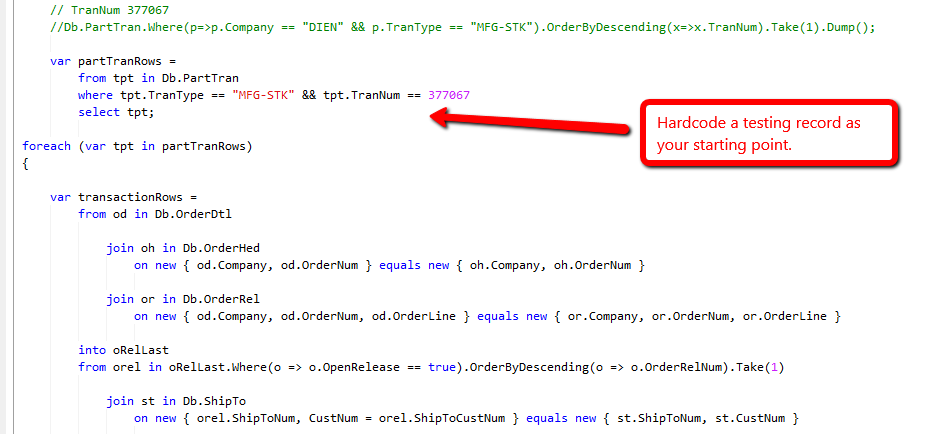

@IanCastellanos Regards to the LINQPad for Prototyping⌠there is obviously no ttâs but I always pretend I have one which I replace in the BPM with the actual tt when I am ready.
Also you cant do some other things like Db.Table.With(LockHint.UpdLock) - you can add LockHintâs like NoLock and UpdLock in the BPM later, just not while in LINQPad.
