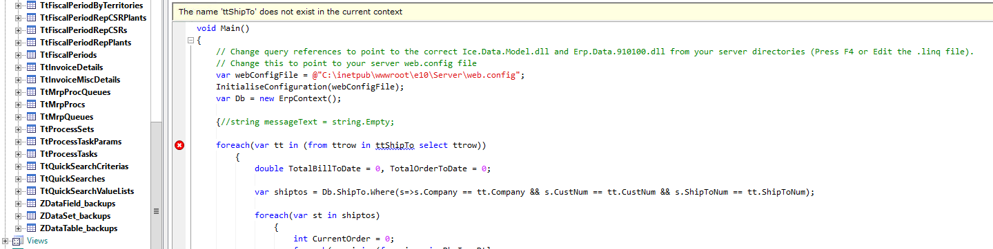

Got LINQpad4 all set up and have run into what I think is a big problem. Seems that there is no ttShipto in our databases Which makes me wonder what the code is exactly doing unless I am missing something. Which could be the case since Epicor is still new to me.
