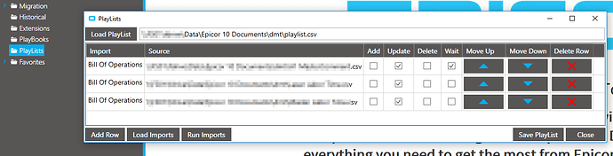

You could also make a playlist, which isn’t as slick as powershell, but a bit easier to set up. If you over write the CSV’s as the same file names and locations, you can use the same playlist over again.
Banderson,
Thanks. I’ll take a look at the playlist option too.
