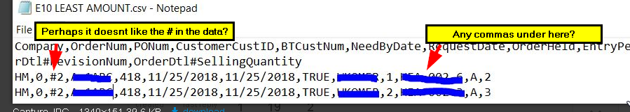

I’m trying to use the sales order combine to enter multiple sales order lines.
I am able to successfully import the first line however, the second line does not import. I do have the OrderDtl#OrderLine field set to 2 on my second line. Line two always throws the error “Input array is longer than the number of columns in this table” This is a CSV file and I manually entered the data into the form as I’m creating a new order not updating an existing one. I have reviewed it in notepad and do not have any extra columns. I can’t figure out why line one is successful and line two errors out. Anyone have any idea as to what might be going on or how to fix it?

I created a CSV file that has two lines and I can import them without any errors. Is there any special characters in the Part Number?
Try moving line 2 to the top and see if the DMT still works.
Thanks for the suggestion. I removed the # but same result. No there aren’t any commas in our part numbers, but they do contain dots and dashes.
I even tried putting in line 2 first. Whatever is in line one will import and line 2 always throws the error.

Company,OrderNum,PONum,CustomerCustID,BTCustNum,NeedByDate,RequestDate,OrderHeld,EntryPerson,OrderDtl#OrderLine,OrderDtl#PartNum,OrderDtl#RevisionNum,OrderDtl#SellingQuantity
HM,0,4,A-1ARC,418,11/25/2018,11/25/2018,TRUE,WKOMER,1,HEA-002.6,A,2
HM,0,4,A-1ARC,418,11/25/2018,11/25/2018,TRUE,WKOMER,2,HEA-002.3,A,3
