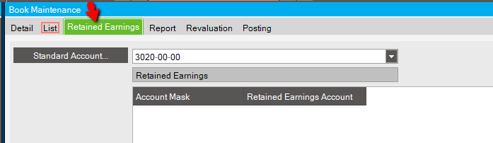

I guess its an Account you set on your GL Book:
So possibly go to your GL Book Maintenance and see what the RE Account is and then Open That with (via right click open with) General Ledger Account Maintenance and Verify its Activate and that its From and To dates are not expired.

Thanks to everyone that advised me on how to resolve the error message RE account is wrong! When I looked in Book Maintenance, Retained Earning account, the correct account appeared. However, Epicor kept telling me that the RE account was inactive.
I finally deleted the entry and reentered the RE account manually. The initial load was done via a DMT. After manually adding the RE account, I returned the journal to Journal Entry and attempted to post a second time. This time it worked! When I opened the DMT I noticed the row after the RE account was highlighted. I think Excel stored a hidden character at the end of the RE description, which was loaded when I processed the DMT. I cleared the highlighted area, resave, repeat the DMT load, added another journal and it worked for the other 13 companies I was creating!
