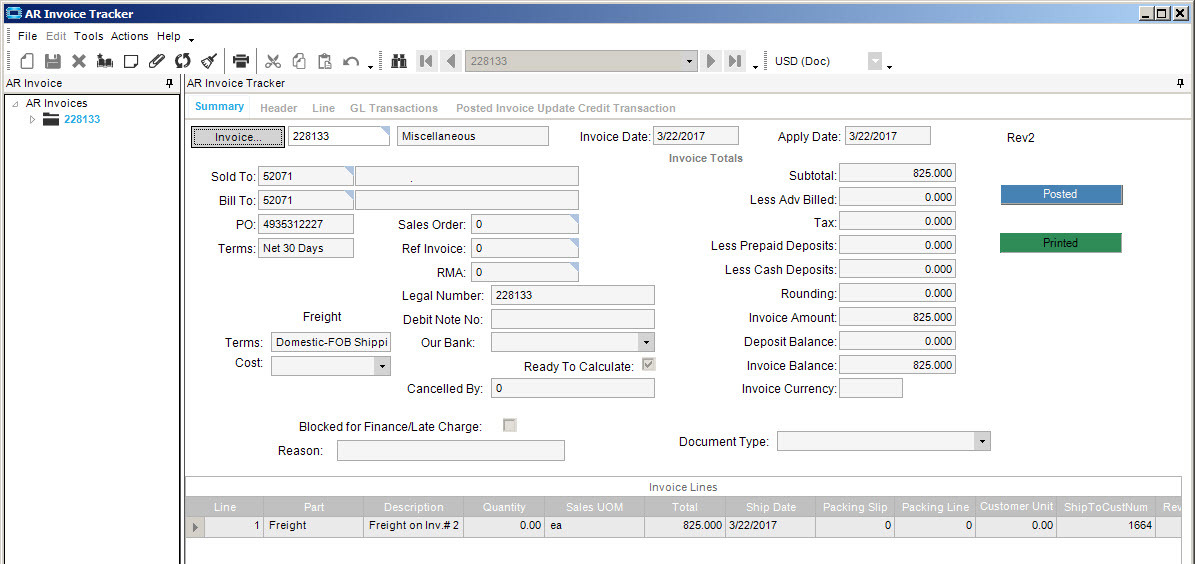

Ok, I can get there on the general look of the login and main menu / home page type differences, this I already prefer.
However, are you telling me that you are using forms that look like this dark e10 one compared to the e9 one and prefer this dark e10 one?

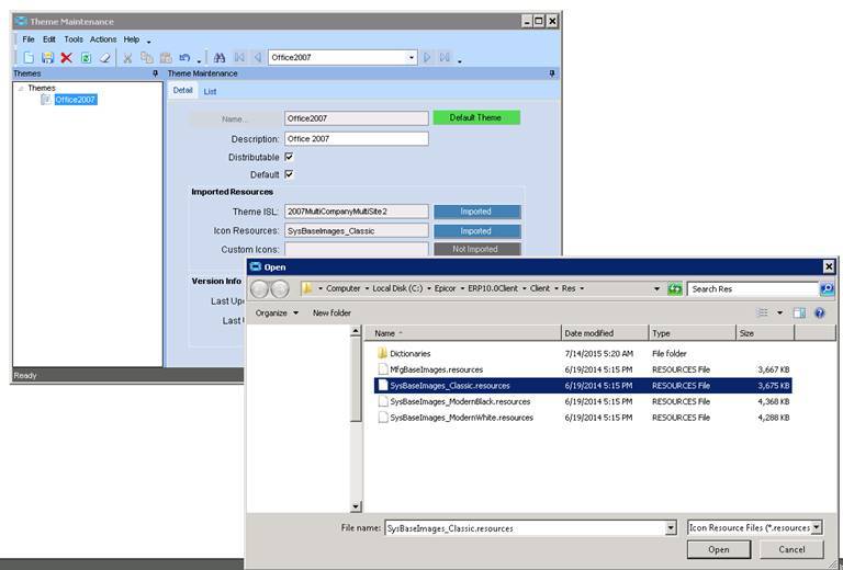

In Actions you can import the Classic icons as well.

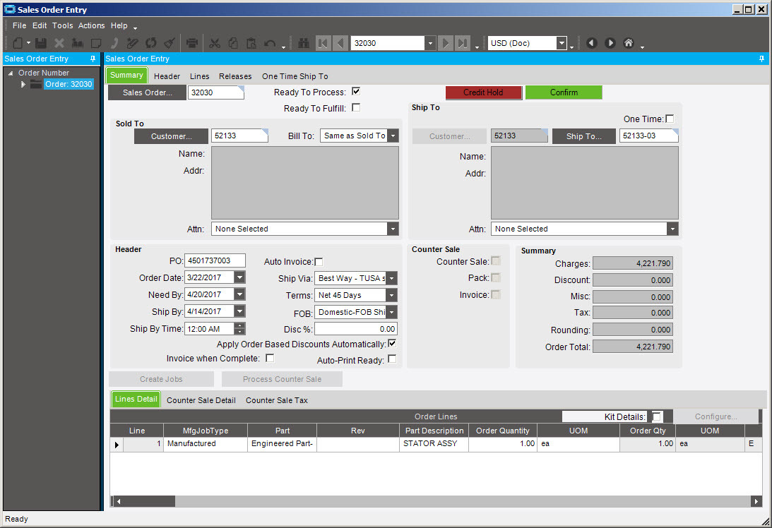

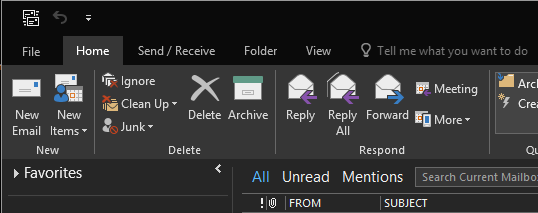

Yes, I prefer the dark now. But maybe it just more closely matches my overall taste in UI. For instance, here is what I have my Office 2016 theme selected to be:
And here is what my coding tools look like:

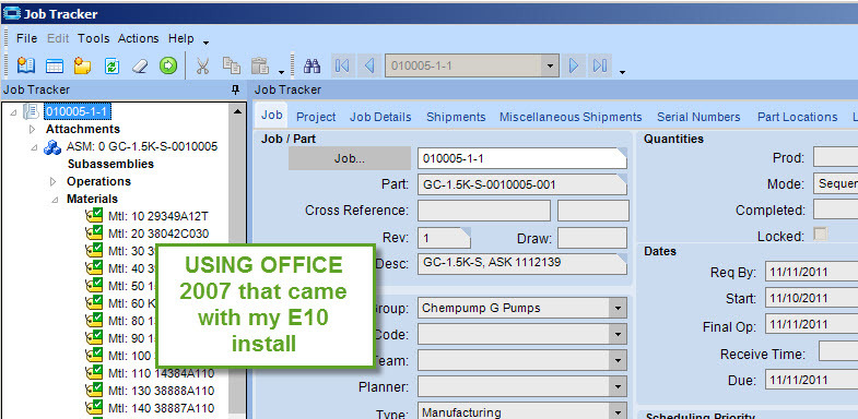

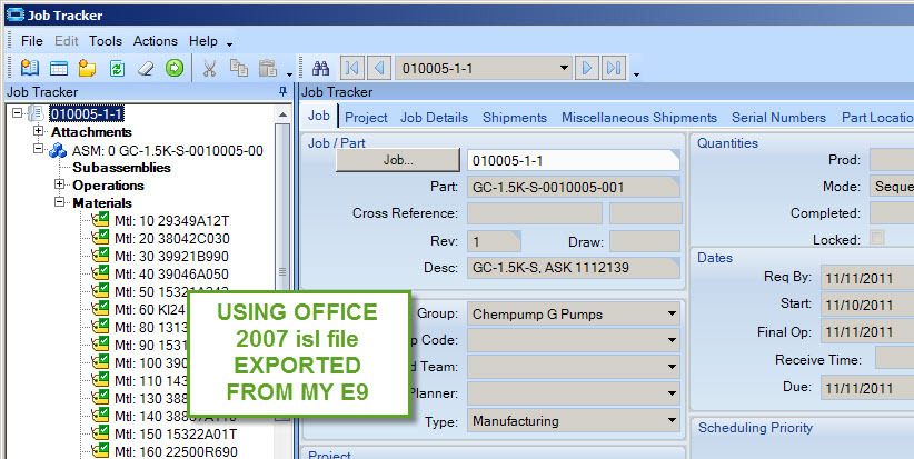

Hi Randy,
I was thinking the same thing as you, then re-read some of the posts and thought “Gee, why is Jose telling me to export office 2007 theme from E9 and then import it to E10 when E10 comes with it canned?”. Interesting thing, Jose is right! See below difference from when I use the Office 2007 file from export from E9 then import into E10 vs using the Office 2007 theme file that came with the E10 install.
Using the E9 Office 2007 isl file along with Andrew’s suggestion to import classic icons, and I think we’re going to be able to let people who love their E9 interface to pretty much keep it.

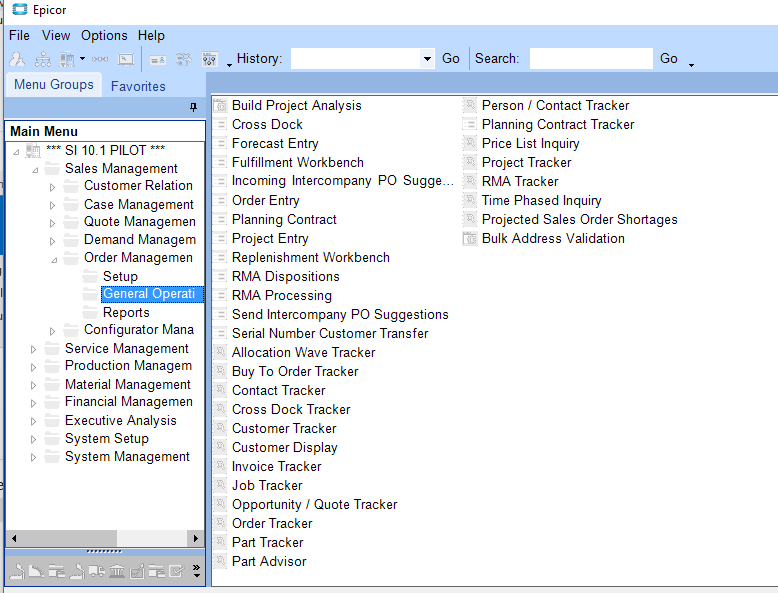

Odd, our Office2007 10.1 theme loads looking like this, the blues are OK
but the Icons are all white and hard to see.
Hmm, I tried it again and same white icons. Anyone have an idea why our Icons don’t look like Nancy’s?
I tried both our E10 legacy and E10.1 servers.

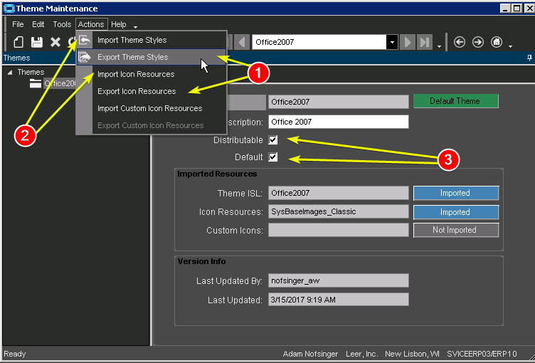

You need to set it as default in Theme Maintenance and then exit and go back in… as shown here
