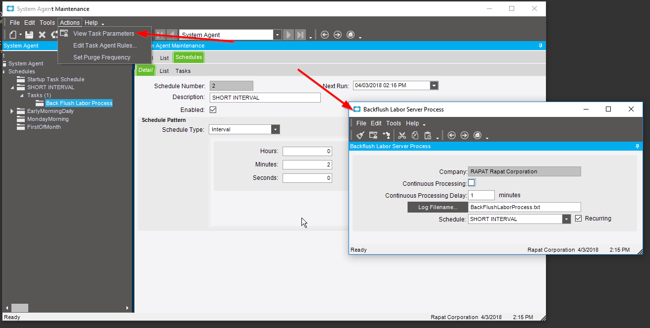

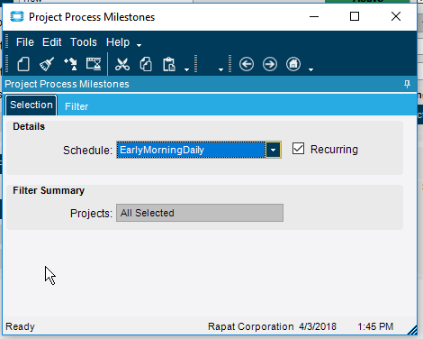

You can set the schedule with that screen. You need to create an applicable schedule with the system agent to run when you want, then you can pick that schedule when you process milestones, check recurring, at it will run at the frequency you decided.
Also, it looks like there is a filter applied automatically based on the project that you are in, make sure you go to the filter tab and delete that row before you submit the scheduled one.

Thanks for the reply, Brandon. Our consultant did something similar to this except he cleared the filter to apply to all projects. That seems to be the problem. I’m thinking that we need to do this on each individual project. The only thing is, I’m not sure if this will be a problem since we have a lot of projects.

I think?? (someone answer this for sure) that you can attach quite a few things to schedules without issues. Then you would just need someone to kick off the schedule at the beginning of the project, then when the project is done, it would probably be smart to remove the ones that are no longer needed. At least it’s better then going into each one repeatedly to fire the processing. You can see the parameters for the tasks that you have in your schedule in the system agent so you know which ones are working.
you can definitely have more than one task associated with a schedule.
