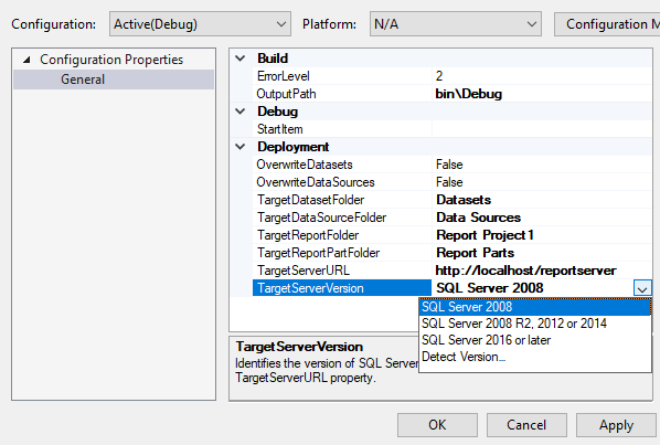

Did you set your TargetServerVersion in the project properties?
I can’t remember now if I tried changing the TargetServerVersion. After not being able to connect to our server, I gave trying to integrate Visual Studio into our server. Just use it for viewing and searching the .rdl files.

I was at the WI EUG meeting last week and it was discussed not to use the latest SSDT as it’s has some compatibility problems. However, that said, I downloaded Visual Studio 2015 Community and it’s SSDT but haven’t tried to do any SSRS yet.
SQL SERVER 2014 OR HIGHER https://www.microsoft.com/en-us/download/details.aspx?id=42313
SQL SERVER 2012 OR LOWER https://www.microsoft.com/en-us/download/details.aspx?id=36843
