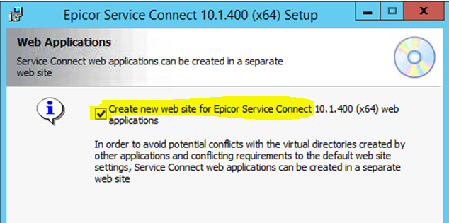

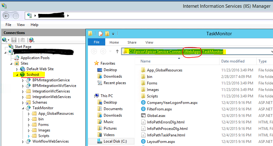

During installation of ESC you are asked to create a new website for your ESC applications (Task Monitor, SC Integration Web Service, etc.). It will create “scshost” website on the server where you are installing SC (on the local IIS).
The website files will be stored under “C:\Epicor Service Connect\WebApps*”
Open up IIS console and check your websites.

Open your internet browser and try:
https://yourserver/TaskMonitor
http://scshost/TaskMonitor/
You should see the login screen:
