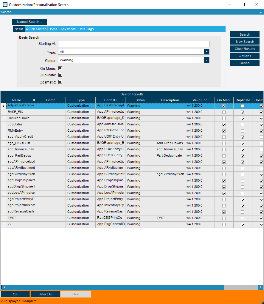

I did a Force Validate (without the No Check because I wanted to check them) on all of the f screens, it did remove the f. There were 2 screens which complained about possible memory leaks and have a blizzard of warnings when I say not to automatically fix them. Both of them are specific to a given company though, so Iâm not sure what to think of them. They both run correctly. They just now have a w instead of an f. Some of the warnings donât seem to make any sense, others do. (we often get warnings about field overlap, but itâs usually intentional because we donât want to display some fields the way Epicor wants to)
