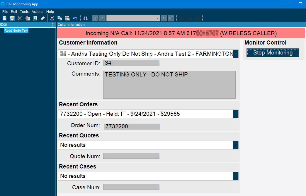

Sure thing,
Basically our phone system has an interface we can hook onto when calls come in which you can subscribe to and trigger an event in a windows application. We simply wrote a windows application that listens to those events and when a call comes in we use the phone number to do a lookup in Epicor and figure out of its a Customer, Vendor , Contact, etc then we wrote several screens which pop up with information regarding who may be calling. Vendor (Open PO’s, Open AP, Last Contact etc…), Customer (Open Orders, Open AR, Open Quotes, Last CRM Call, Open Cases) etc…
