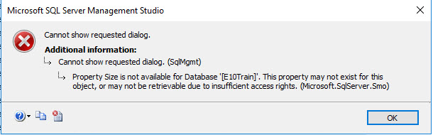

I can’t click properties on E10Train when logged in as SA. When I do I get this message:
e10-train-properties-error
Does anyone know how to make it not single user mode so I can go to properties on it?
Did you try running a query like this making sure Master is your context
-- Start in master
USE MASTER;
-- Add users
ALTER DATABASE [E10Train] SET MULTI_USER
GO
Wow that worked as easy as that! Thank you.
