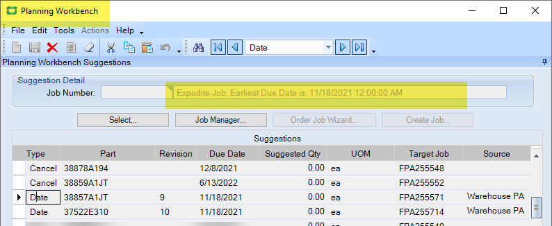

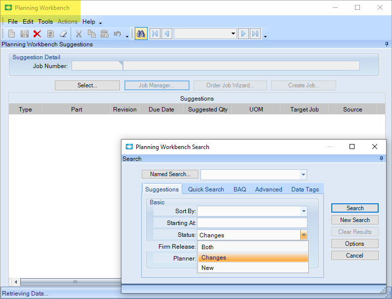

Hi Randy,
The Planning Workbench shows job change suggestions. It notes suggestions for cancellation, expedite, postpone, etc.
