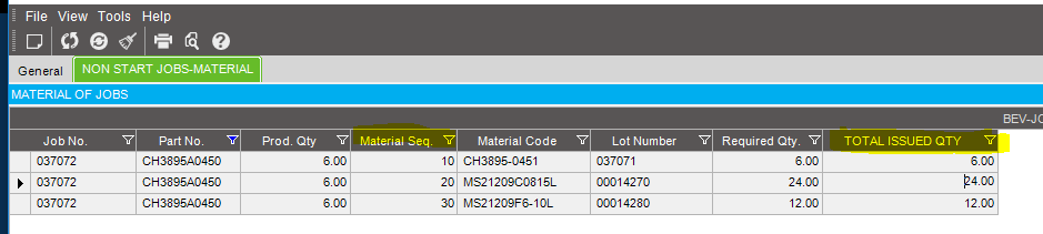

this is my BAQ, to check issued material, for any open non started Jobs, alter it to suit your use then add it to a dashboard if you want, you may need to replace my subquery to show total material on Hand instead of total issued, then add a calculated field on the top level query to check each material row i.e. if total mtl in stock is higher than job required material for each line then give true etc
Note: My Epicor version is 10.1.400.20
BEV-NonStartedJobsMtl.baq (30.9 KB)
I am going to give that a shot @Rick_Bird you were closest to the mark of what I’m looking for. In a single dashboard row yes or no are the materials good to go.

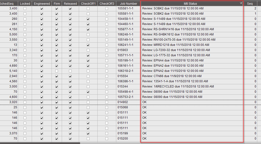

That was the ticket, works great had to handle exceptions in a goofy way but here it is for my purposes
foreach(var tt in ttResults.Where(x => x.JobOper_QueStartDate < DateTime.Today.AddDays(45)))
   using (var job = Ice.Assemblies.ServiceRenderer.GetService<JobEntrySvcContract>(Db))
     List<string> exlist = new List<string>();
     // Create job filter
     JMtlStatFiltersTableset filter = job.GetJMtlStatFilters(tt.JobAsmbl_JobNum);
     filter.JMtlStatFilters[0].CutoffDate = tt.JobHead_DueDate;
     filter.JMtlStatFilters[0].ExceptionsOnly = true;
     filter.JMtlStatFilters[0].RowMod = "U";
     // If we were able to create the filter carry on
     if(filter != null)
       try
         JMtlStatTableset stat = job.GetJMtlStat(filter);
         if(stat != null && stat.JMtlStat.Count > 0)
            // Build exception list
            foreach(var mtlex in stat.JMtlStat)
              exlist.Add($"{mtlex.PartNum} due {mtlex.DueDate}");
            tt.Calculated_MtlStatus = $"Review: {string.Join(", ", exlist)}";
       catch(BLException ex)
          if(ex.Message.StartsWith("No materials required for"))
            tt.Calculated_MtlStatus = $"OK";
          else
            tt.Calculated_MtlStatus = $"!!: {ex.Message}";
Results in
