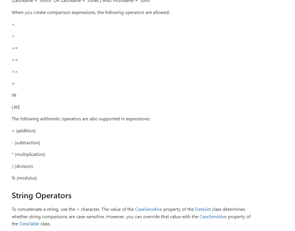

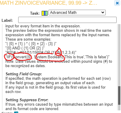

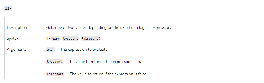

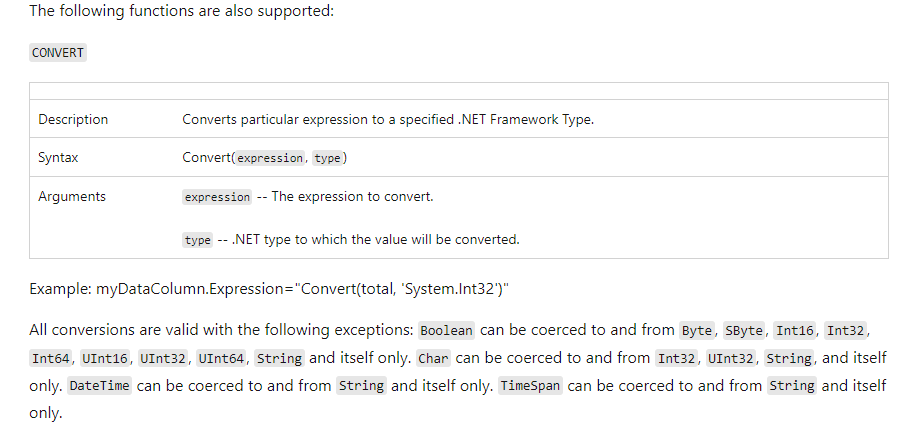

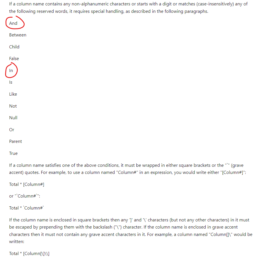

Yeah I think I got it, cause everything in the DataColumn.Expression link is what I see briefly mentioned in the ECM documentation:
Notice the circled expressions in the first photo: IN, IIF, Convert, AND, etc.
In the later pictures look at those same things on the microsoft learn documenation.

I guess what I am asking is that the person from Epicor is pretty much saying any of these fly in the advanced math task, right? @klincecum
Thanks for showing me something new on that object. I can use it.
That’s what I got out of it as well.
after reading these links, I agree with you. I’m a bit confused but I read it as the first link for Compute function specifies that the expression must be an aggregate function, but where the first argument (expression) is actually defined by the second link (DataColumn.Expression).
I’m guessing that ECM takes care of the aggregate function side and we just need to focus on the string expression.
