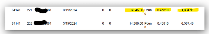

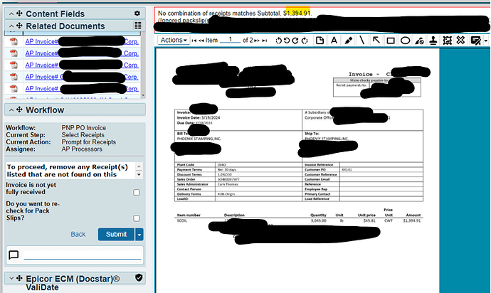

Our AP Clerk recently brought up that the Invoice Match is only looking at receipt headers when calculating the match in our AP Automation workflow. So if we receive two items on a shipment but our vendor bills us for each item on separate invoices, ECM isn’t recognizing that it can match one of the lines from the receipt. We have an example below.

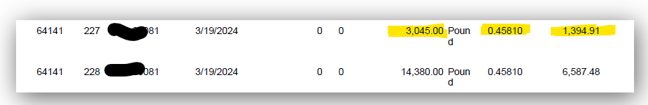

The receipt in question: notice it has two lines received on the same packing slip from the vendor. The quantity and for Line 1 match the invoice.

From my experience, this ultimately comes down to how ECM will not recognize a line on a receipt but instead it is looking at the entire receipt value. For the PNP workflow, which is the header/footer style, you would be looking to match your invoice subtotal to a receipt total. In this case you have two separate invoices, each with their own subtotal, and one receipt. Vendors don’t typically provide two invoices for one shipment so I am curious if this was more of a receiving issue than an invoicing one. You could split the receipt in Epicor so that each line is its own receipt and then run each invoice through ECM to match them up with their respective receipt entry.

Thank you for the insight! I wasn’t involved in our implementation so it’s good to hear that this is expected behavior. I’ll have to check with our Purchasing, AP, and Receiving departments to see if something changed in how we’re processing this vendor. We’ve had a few process changes around purchasing so something may have changed that we didn’t expect.
