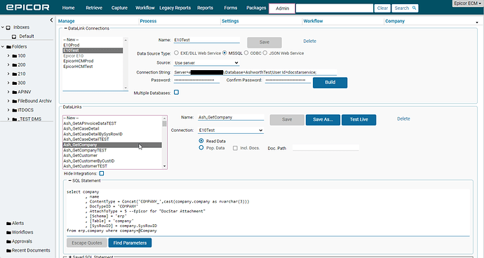

Making your own datalinks is super easy. On the Admin tab → Datalinks tab. You create a Datalink connection to your ‘data’ then create a DataLink. I’ve got dozens of datalinks to my Kinetic DB and I look stuff up all the time in my workflows.
Given that, altering a step in the workflow to test the values for Inspection Required and then pausing the workflow should be quite easy.
Like Mike said and your consultant as well, you’ll have to make your own datalink and then add this to your workflow step and action and then branch off properly given the result of your datalink (whether it’s in inspection or not)…

What was a little surprising to me was needing to write out the SQL statement for the DataLink. I guess I’ve been so conditioned with widgets and other GUI’s that do this stuff for me in Epicor products that I was expecting something similar here. Lucky for me, we have someone on staff who’s a high level SQL guy that I can lean on.
Based on what I was seeing in the workflow, I’m not concerned at all in getting this part added in. That part seems very straightforward.
