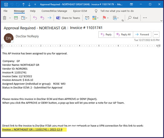

I am more curious about the format of your approval email/message. Ours looks nothing like that, nor can I find a mechanism to author my own format. Can you share where this is done?
This is the standard behavior for the link in your email - I know of no single click approve/deny feature. However Iā€™d like to explore it, and how you got both links in there.
It was built by a consultant so i cant really help with how we got those items in there.
Agree, link is just link would only work if you were VPN or onPrem. Iā€™m not sure how ECM sends out emails myself yet have not investigated this feature yet myself and would love to know how from anyone. :slight_smile:

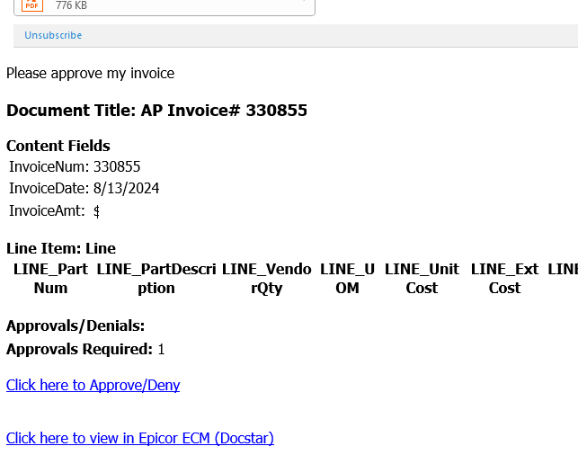

The Request Mobile Approval task is used to email a user that an approval is required by them and they can approve or deny the invoice entirely outside of logging into ECM.

The bit that told me what Iā€™m missing is the Email Task INSTEAD of the Notify checkbox. We use the checkbox. Our emails are very rudimentary. I know I can do more with the Send Email, but it never clicked that I could use it for the Approval. I see now that the screenshot above is using the Send Email link with some fancy HTML, but the links are not under our control regardless.

Just to be clear, the screenshot above is the email received from the Request Mobile Approval task. The Send Email task is a different format and is not actually linked to any approvals. The way I use this task is in place of the generic Notify email. The Send Email task is much more robust to provide better details and direction to the user.
As an aside, the Mobile Approvals license is required to use the Request Mobile Approvals task.
I want to repeat what @vleveris shared, because I followed the same method for my ECM workflows. Victor pointed out:
[For Approvals . . . ] There is also an option to Notify the user [via a generic, non-customizable e-mail], but I have always found it better to use the Send Email task and inform the user about this.
The Send Email task is a different format and is not actually linked to any approvals [, but that task is part of the documentā€™s WF and is likely placed within the Approval step]. The way I use this task is in place of the generic Notify email. The Send Email task is much more robust to provide better details and direction to the user.
The remainder is my own commentary: None of my Approval tasks had the Notify checkbox checked; meaning, we never allowed ECM to send the generic e-mail notification. Instead, I added an extra Send Email step to send out a customizable e-mail.

An example, although the additional recipients are not shown:
Send Email Example - AP Invoice Approval
Two limitations of using the Send Email step in lieu of the generic, non-customizable approval e-mail notifications:
  1. The customizable e-mail from the Send Email step will not have an Approval / Deny link. But it will have a link to the document in ECM.
    I always made sure that my Approvers had Retrieve as their default tab in ECM and that the Approval Accordion was visible and at the top of the Retrieve tab. That way, when they open the document from the ECM link, it goes right to the Approval Accordion with its approve, deny and/or other buttons.
  2. I could be wrong, but relying on the Send Email step only might prevent any follow-up generic e-mails from getting sent to the user about outstanding approvals, such as you havenā€™t taken action on this approval request in X days.
