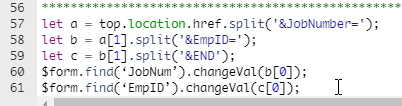

We actually have managed to achieve this in the end. Having dropped the project for a while my colleague and I had another look and with his Java script skills we have now been able to build an ECM form link and read values from it and pass them into the form.
This is a real game changer for us as I thought we were dean in the water with this. So if anyone else want to do the same, here’s what we did:
In this scenario we are launching a form to collect data about a job from MES so we wanted to pass in the Job Number and employee ID to do this we added the following to the end of the form URL
&JobNumber=1234&EmpID=AA11
Then in the Java Script
let a = top.location.href.split(“&JobNumber=”);
let b = a[1].split(“&EmpID=”);
let c = b[1].split(“&END”);
$form.find(‘input[data-name=“JobNum”]’).changeVal(b[0]);
$form.find(‘input[data-name=“EmpID”]’).changeVal(c[0]);
And then these values are read from the URL and put into the fields JobNum and EmpID

Just edit the java script
Then insert the code:

I did see a difference - and maybe it’s version related. When I insert your code the lines show an error until I change it to this. We are v22.2.120 currently.
