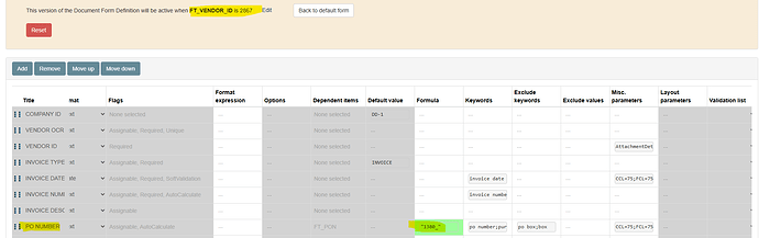

i have created new DFD for vendor id = 2867 and put the logic in PO field

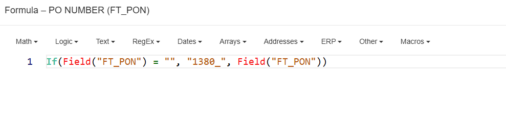

Doesn’t work the formula can you help me?
The way IDC handles formulas is a little different. I am not 100% sure of the syntax, but I believe that this will work.
IF(EQ(“FT_PON”,“”),“1380_”,“FT_PON”)

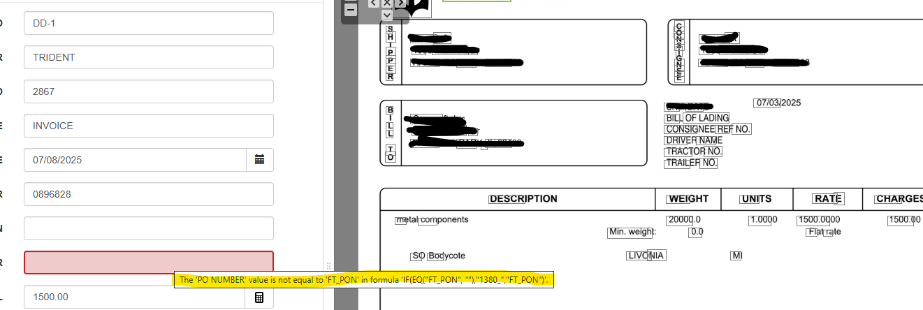

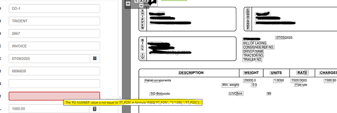

Doesn’t work
i applied the rule for vendor id 2867, and i got error in PO field it should not fill value 1380_ which i want to

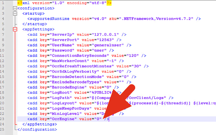

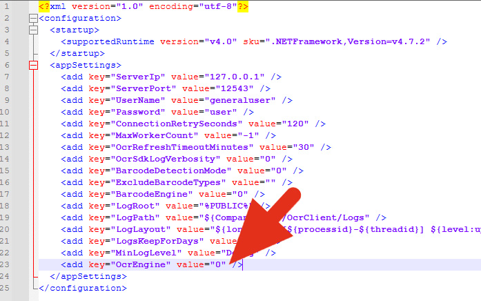

Most likely, Azure OCR engine is not in use.
You can check this using SsiOcrClient.exe.config located in the Automated Clients Installation folder.
If the value is 6 for the OcrEngine then Azure is in use.
is that correct logic?
Apologies, I added quotes around the Field ID when it shouldn’t have them. Try this:
IF(EQ(FT_PON,“”),“1380_”,FT_PON)
NOTE: You may need to replace the " character by retyping them.
