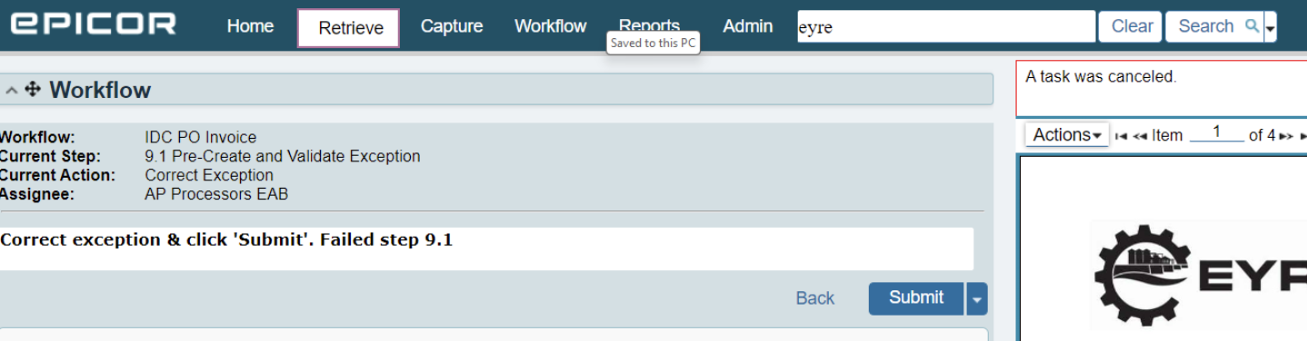

ECM: If my DataLink runs for too long, I'm getting the 'A Task was Cancelled' exception in my workflow
EDIT: EpicCare case number: CS0004717723

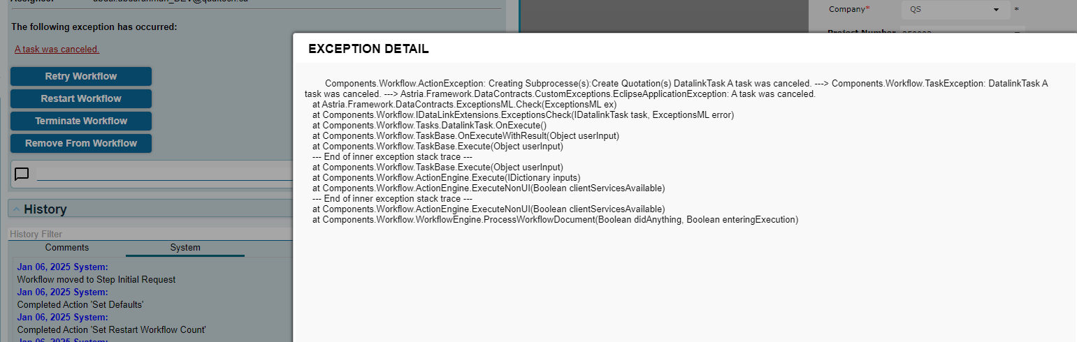

I have a DataLink that can takes 1-5 minutes depending of the number of subprocesses to create. It calls an Epicor function which then calls the ECM API to create one or multiple documents. Each calls takes about 30-45 seconds so the 3 minutes limit seems broken for a longer example. It still creates all the subprocesses but it’s annoying to get an exception in ECM because the user won’t really think about fixing it since it’s an asynchronous task

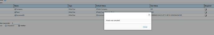

I just run the DataLink in the Admin tab and it returns the same thing but faster (Took about 1 or 2 minutes to get this message):
If I run the function via the Epicor API (Swagger page , v2), everything is OK. It’s really only the message on the ECM side which is causing problem in my workflow
Code: 200:
Return:
“ReturnMessage”: null
Request Duration: 163061 ms
The ECM support guys are usually pretty good and I suspect you’ll need to get to them to figure out how to change (find out which) timeout settings - or have them help figure out why it’s cancelling in general.
Other option would be to figure out how to make the Function trigger asynchronously and release the ECM workflow datalink call more quickly. Perhaps the data link does a UD table row insert, and the function is called by a directive on the UD table row insert?

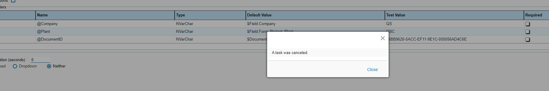

I believe there is a Datalink Timeout Connection limit in Admin > Site Settings that may be worth reviewing, too.
It didn’t change anything unfortunately. Tried to put a high value (100 000) and still the same problem
