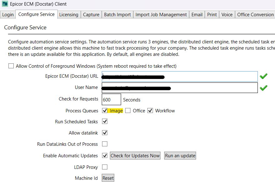

To add to what @gpayne recommended, you can also force the system to image a document through the Actions menu > Requeue Imaging function. In order for this to work, you need to have an active ECM Client listed in the Distributed Queue Management panel under Queue Processors. This ECM Client must have the Image option selected. Also, if you need to image Microsoft Office documents you will need the Office option selected and either Microsoft Office running on that machine or Libre (sp?).

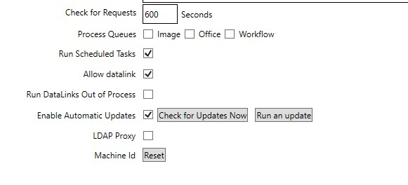

For some reason, my Configure Service tab didn’t have any of the Process Queue tick box ticked.
After I ticked that tick box, the queue started to reduce.
