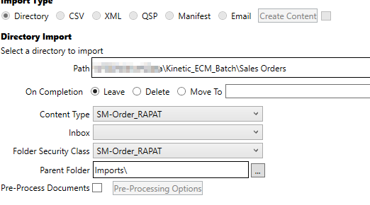

I would like to be able to assign the order number field from the folder name that they are coming from. For example
I drop folder 400002 into the Sales Order watch folder and it contains documents related to sales order 400002. Is there a way to pass this to the OrderHed.OrderNum field? I was able to use Extract Text to pull it from within some of the documents but that won’t work for all the documents.
Unfortunately, I do not believe this is possible within the ECM Client as you’ve explained your requirement to be. I would recommend the CSV import type instead as you can index the fields you require. While this would be a lengthy task to complete manually, you could use Excel to capture the file path, which you need anyways, and then substring that value to get the folder name indexed into the appropriate field.
I’m not sure if Epicor is working on adding more functionality and features to the ECM Client for instances like this, but there is usually a workaround… albeit they are often tedious and time consuming.

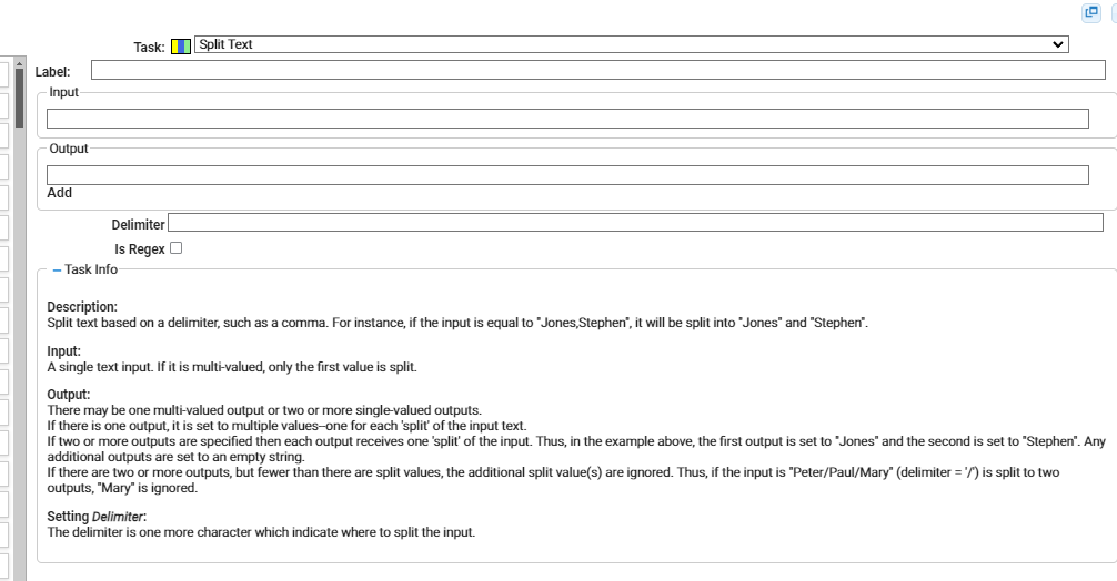

One thing I have used, if the document name contains the identifier 400002, you could split the Title which by default is the name of the document file into fields. Example - split text on period
400002
PDF
Using the split text task allows for the outputs to link to fields and if using a REST call to lookup the SysRowID will allow for attachment of the file to Kinetic.
