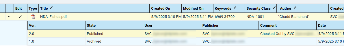

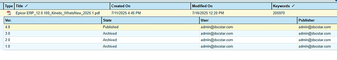

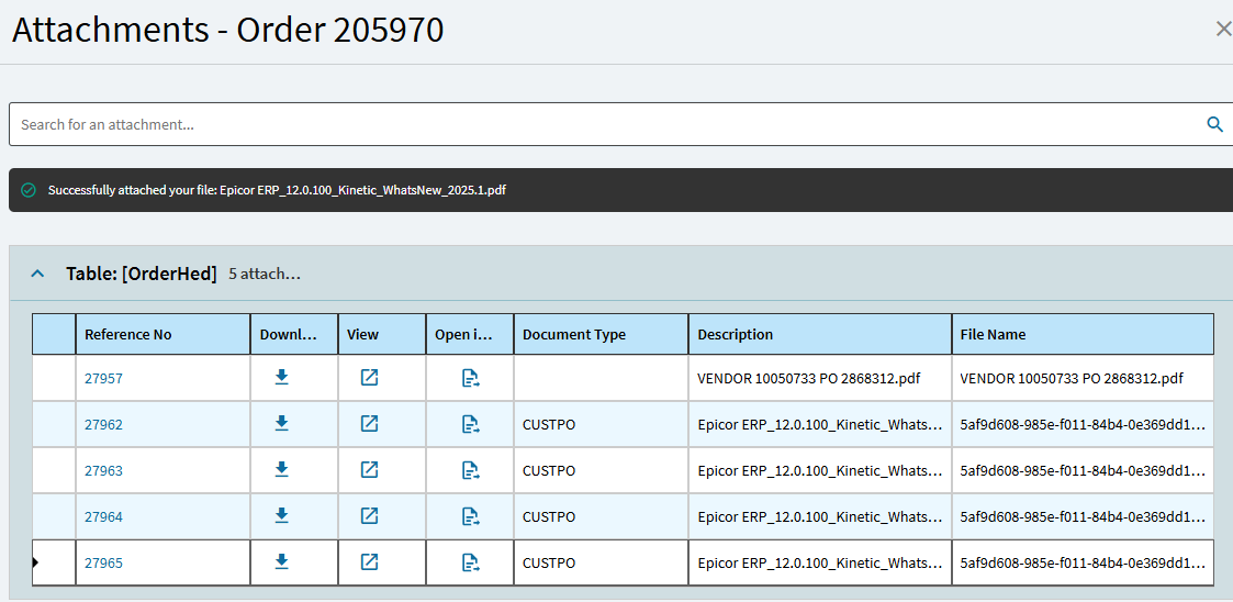

We are currently implementing ECM (on-prem) and I was under the impression that the versioning and/or the message of overwriting an attachment of the same name would result in a single attachment, but I keep getting multiple attachments of the same name, while inside ECM I do see a single doc with versions listed.
Am I mistaken in my misunderstanding of how the attachments within Kinetic work/appear, do I not have something set properly perhaps, or is this a bug in 2024.1.9?
I’ve noticed that too. It appears that ECM knows to version it’s file, but Kinetic does not.
I also found this out recently and since it was confusing to the end user I had to just not use it.

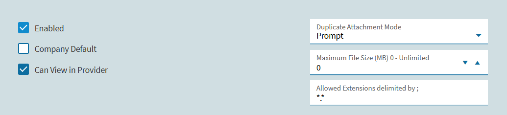

By “it” I assume you are referring to versioning? With versioning off for the document type you get the overwrite message and Kinetic maintains a single attachment? Do you have the duplication setting in Attachment Type Maintenance for ECM set to Prompt or something different?
one sec
I am referring to versioning when I say “it”. And yes I get the duplicate message.

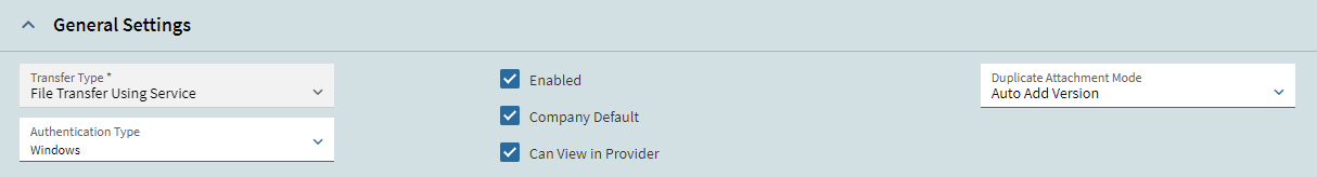

I sent out about duplicate attachments and also pictured here is the setting on the attachment type:
