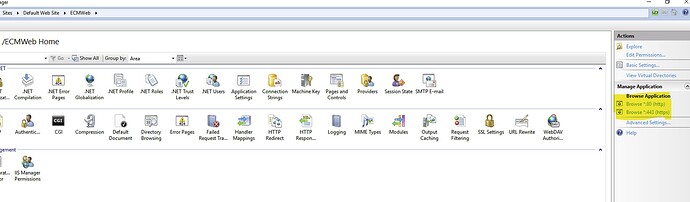

You can browse all websites by opening them from IIS without error?
Sorry I don’t know how to do that in IIS?
The one with 443 works fine.

I will see if they all work in the Test environment and see how that compares to Live. We don’t have these issues in Test.
In our Test environment we have two sites that work (I think they’re duplicated). One is called EclipseWeb and the other is ECMWeb and both *:80 and *:443 work.
In our Prod environment EclipseWeb works for *:443 but not *:80.
None of the other ones work for either Test/Prod.

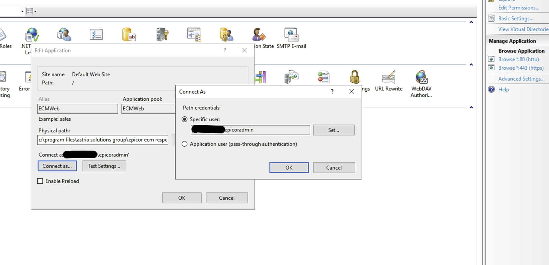

Can you try to use the admin account on that app pool and browse?
I typically see issues within the system if you can’t browse to :80 from IIS.
