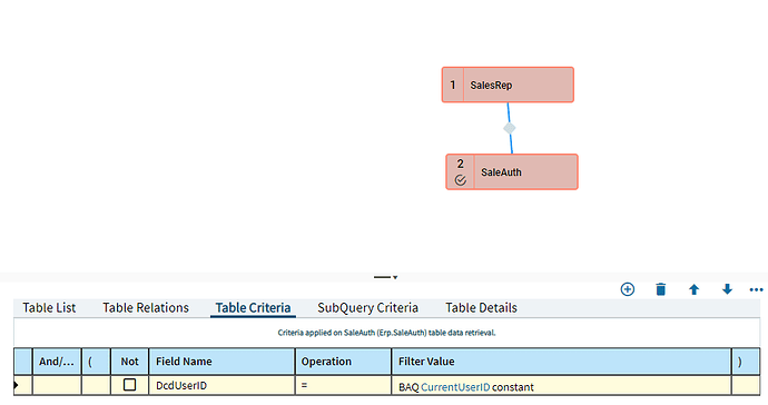

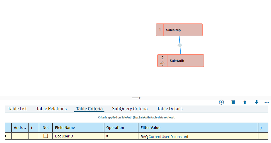

The BAQ knows who is running the query. You could use the SaleAuth table to return all of the SalesRep IDs that the person is authorized for. Take that list and find whatever you’re looking for (orders, quotes, etc.). This should reduce the number of records.
Hm, thats a very nice idea! I was thinking about using current user as a filter, but was not aware about SaleAuth table. This for sure would allow most of the sales people to use EDD to get their own data. And for those, who needs a bigger picture and filter through - dashboard! Thank you Mark, you are definitely not a quitter and gave me an option!

With some nested BAQs you can do some basic parameterized filtering. Can do things with like the dynamic variable BAQ knows about. Like current site. You could get it to filter dynamically by adding that to a BAQ. Or the SaleAuth like Mark showed.
