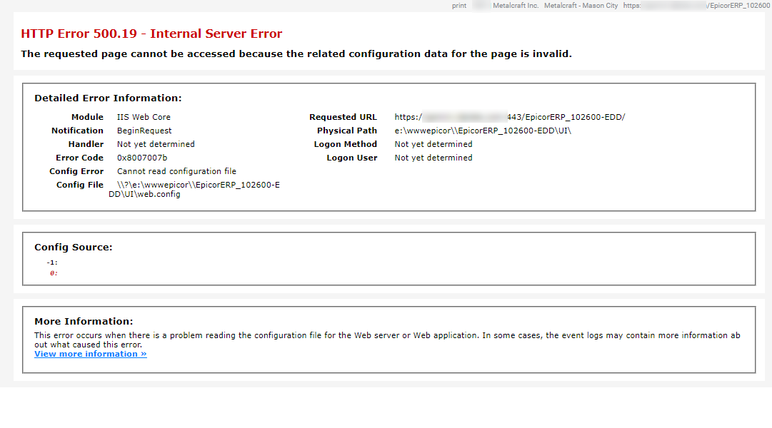

Anyone seen this error before when installing a new EDD extension? Have tried deploying a couple times now with various database and extension names. The config file exists but it can’t be read. Config file exists and looks correct when compared to a previous install. The physical path after I deploy the app is incorrect. It adds an extra \ to the site path. If I remove that the site still doesn’t load.
Figured this out eventually. Had to modify the path for each of the sites. The installer adds an extra \ to the physical path for all IIS sites within the EDD site.
