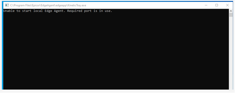

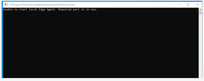

We are in the process of implementing Kinetic ERP and we just rolled out the Kinetic Edge Agent to all PCs on the network. Most PCs just needed a reboot aft er application was installed to get around the port in use error message, but a few continue to see the pop-up message whenever they reboot. Look for suggestions on how to resolve the following error message: Unable to start Local Edge Agent. Required port already in use. Any info on this would be much appreciated.

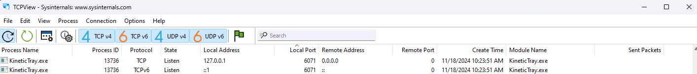

And if you want a graphical, SysInternals TCP-View is nice too:
TCPView for Windows - Sysinternals | Microsoft Learn
