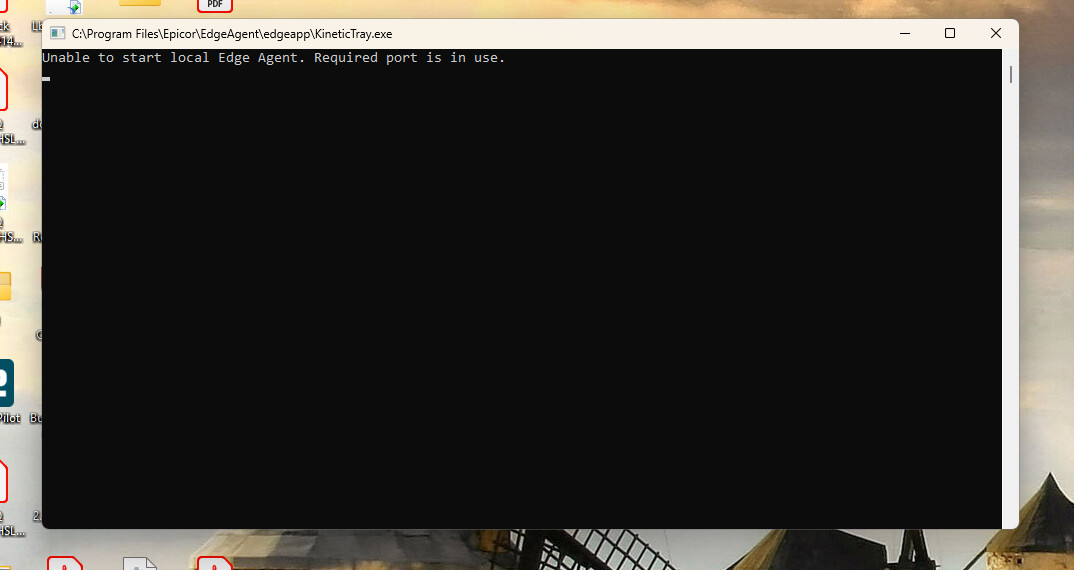

We are beginning to test ssrs reports in the browser version of kinetic in both our production and pilot environments. We downloaded and installed the Edge Agent for both environments as we saw that they are two different installation files. However, when the computer restarts it says that the Edge agent cannot be started as another instance is already running.

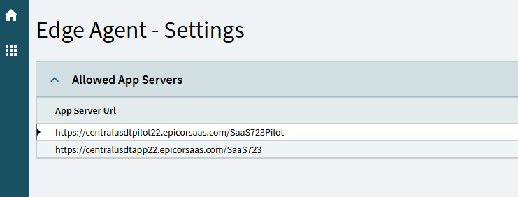

I did go into the edge agent try and add both urls to that screen even though we put those in each corresponding install screens but after rebooting again the error still pops up, however, I am still able to use the edge agent in both environments when trying to print now.
I’ve seen some information that this may only be occurring on Windows 11. While not a huge concern as the agent still works but many users will keep seeing the error initially in the mornings. Anyone else seeing this?
You do not need two edge agents.
Use the latest version and add both your environments.
