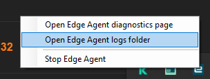

Edge Agent writes log, you should review it when it is not working

This is probably very true, but not accessible by us peons. Big brother (my IT dept.) is the only one who can access this server and logs.
It is for local installation, not network
What if you go to the diagnostics page?
Edge Agent isn’t installed on my machine, it was installed on our server. I can’t access that.
