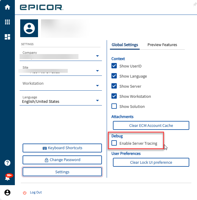

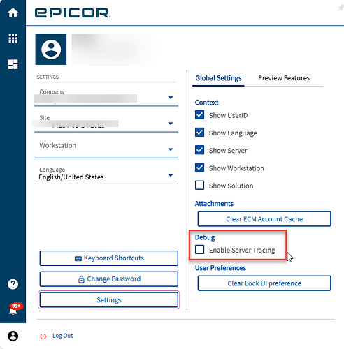

Found out yesterday you can do timing on server side processes by this option and viewable in DevTools Network tab. NOTE: I haven’t tried it yet, but this may help you find out if it’s a processing issue or something else.
Yes, I have used that in past life, and we could do the analysis, but now it is something Epicor has to run once we gather the files and submit. We have a call with Support today to address these issues as well from that end, and I am sure they are going to leverage this as a first step. I just wonder what an average basic print is using Edge Agent.
