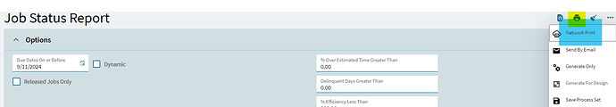

Guess I’m confused…if they’re network printers, Edge Agent shouldn’t come into play…unless you’re using Client Print (printer in yellow) instead of Network Print (three-dot menu in blue).

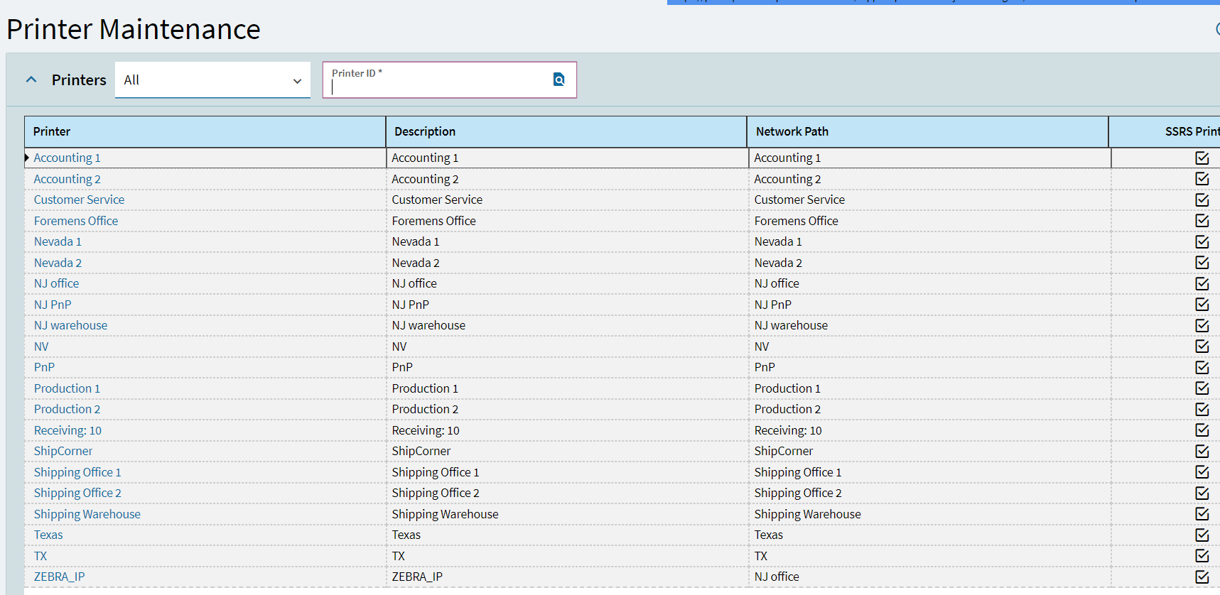

Mal - search for Printer Maintenance in Kinetic. Screenshot of ours below.
There should be a number of printers listed on your end…those would come in under “Network Print”.
John, it has been a minute, but you do have to install them as printers on your app server for them to come in as network printers there in that screen or nah?
Yes…install the driver(s) and add printer(s) via IP…use the app server printer name in Kinetic under Network Path. Haven’t had issues with Network Print except for the occasional IOGear print server glitch (connecting USB Zebras to Ethernet/IP)…and a reboot of it usually resolves the issue.
