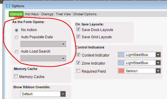

Does it automatically show data when it is launched? Or do you have to search for it?
If it auto-populates, then it might be using a setting in under Tools -> Options (on the menu bar)
If it is set to “No Action” then the loading of data/filtering is being done in code at the form level.
