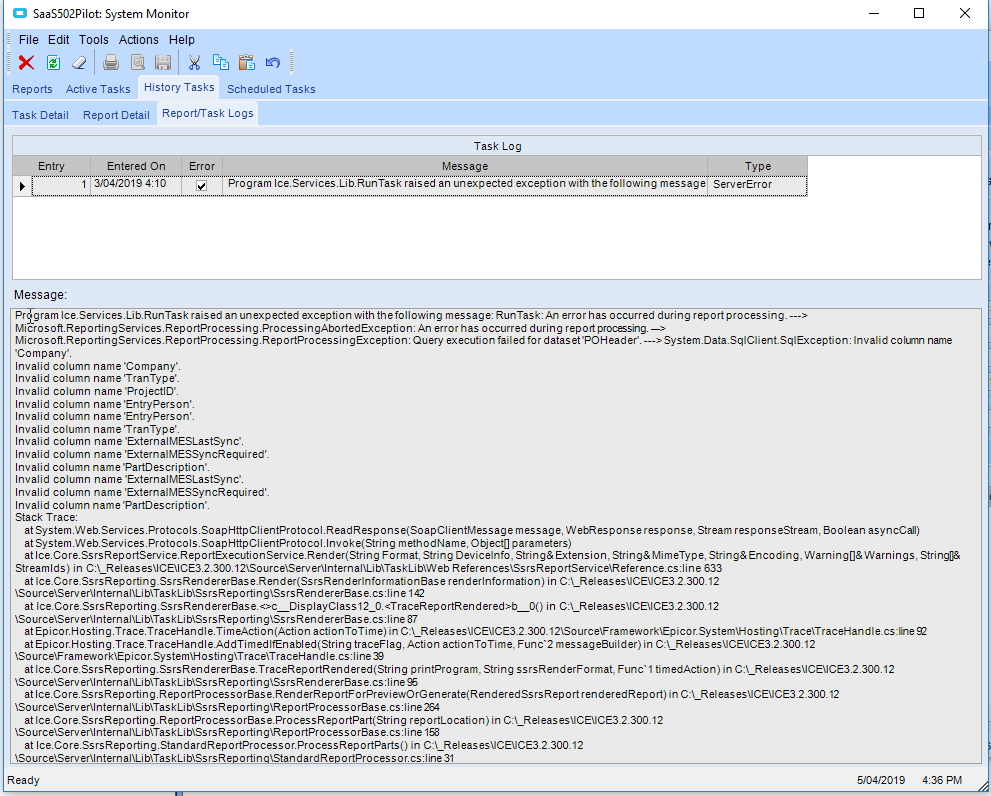

Did you choose “Output” or “Definition” for the join of the added table in the RDD?
Hi mate, I have chosen Output in RDD.
What type of error are you getting? Does the System Monitor show the task status as ERROR on the History tab?
If so, select that task, and choose the Detail tab
copy the first 5 or so lines from the Message, and post them here.
Hey Mate, Even though I have updated the RDD and created the relevant relationship with exclusion criteria, it shows me the error attached as a screenshot.
