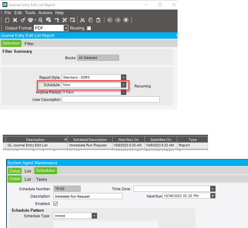

For some reason lately that any of the edit list and with the Schedule being now, it goes to Scheduled Tasks with Immediate Run Request , which is a schedule created by the system on the spot.
This is happened often in the morning and self resolved in an hour or so.
This is annoying… Anyone experience this?
This sounds like a task agent dying and then restarting. I follow this advice here and run a separate background app server with three task agents processing tasks and have not had issues like this in a very long time.
